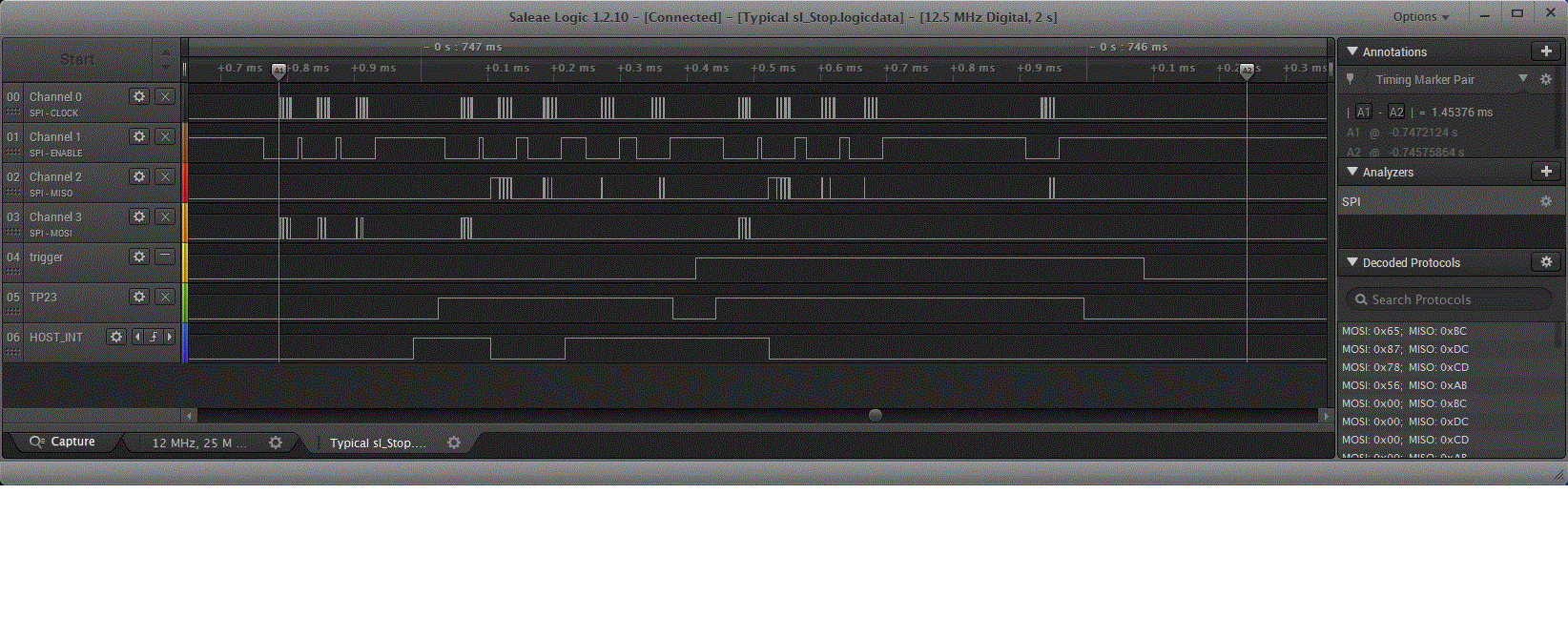

  • Hi Achim,
    You are correct that the information about not needing to implement sl_IfMaskIntHdlr() and sl_IfUnmaskIntHdlr() is not in the template user.h file - someone added it to our user.h file. However, the comment about that can be found here: http://processors.wiki.ti.com/index.php/CC31xx_Host_Interface.
    We are using host driver 1.0.0.10, so this may not apply to you, but it looks to me like you can't mask HOST_INT, because sl_Stop() would not receive the interrupt associated with the SL_OPCODE_DEVICE_STOP_ASYNC_RESPONSE. Here is a logic analyzer capture of a typical call to sl_Stop():
    The signal labelled HOST_INT is the host interrupt signal from the CC3100. The signal TP23 is set at the beginning of _SlDrvMsgRead(), and is cleared just before the call to sl_IfUnMaskIntHdlr() at the end of _SlDrvMsgRead(). As can be seen, the second HOST_INT in this capture would be missed if it was masked. I'm not sure if this is the behavior you would see on your hardware or not. Either way, we both seem to eventually fail for exactly the same reason.
  • HI Ed,
    I think, this depends on the "exact" definition of mask and unmask an IRQ. I searched for that defintion but couldn't find more information within the simple link stuff.
    I see two variants:
    1. mask stops IRQ processing, but events are stills stored in the flags. After unmask, the set flag then triggers the interrupt immediatly.
    2. mask stops IRQ processing and events are not stored in the flags. After unmask, all past events are ignored and only new events will trigger the interrupt.
    For me the 2. behaviour is more a disable/enable interrupt. So my hope is, that TI meant the 1 behaviour. But this may depend on the specification of the host mcu.
