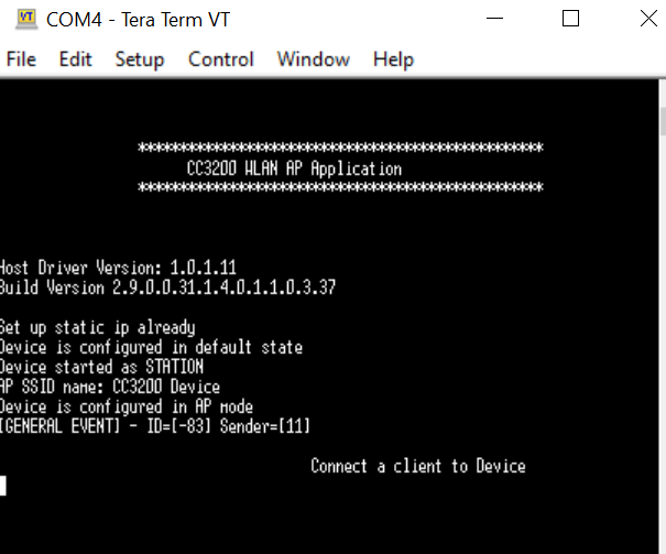

I have tested my android app (client), it is able to connect to another android phone (server) I created, by TCP connection via the same wifi network. So my android app isn't the problem.
However, when it comes to cc3200, i set cc3200 up as an access point TCP server and want to connect my android (client) to it. The access point is set up as a static ip.
    // Enable DHCP client
    //lRetVal = sl_NetCfgSet(SL_IPV4_STA_P2P_CL_DHCP_ENABLE,1,1,&ucVal);
    //ASSERT_ON_ERROR(lRetVal);
    //SET STATICIP
    SlNetCfgIpV4Args_t ipV4;
    ipV4.ipV4 = (unsigned long)SL_IPV4_VAL(10,0,0,90); // unsigned long IP  address
    ipV4.ipV4Mask = (unsigned long)SL_IPV4_VAL(255,255,255,0); // unsigned long Subnet mask for this AP/P2P
    ipV4.ipV4Gateway = (unsigned long)SL_IPV4_VAL(10,0,0,1); // unsigned long Default gateway address
    ipV4.ipV4DnsServer = (unsigned long)SL_IPV4_VAL(160,85,193,100); // unsigned long DNS server address
    lRetVal = sl_NetCfgSet(SL_IPV4_STA_P2P_CL_STATIC_ENABLE, IPCONFIG_MODE_ENABLE_IPV4, sizeof(SlNetCfgIpV4Args_t), (unsigned char *) &ipV4);
    Report("\n\rSet up static ip already");
I added the above codes into ConfigureSimpleLinkToDefaultState()-Function and removed the DHCP-Enable code, however the ip address leased to client is still different?
My android device is unable to connect to 10.0.0.90? Is it because my static ip is not successfully set up?
Thanks, I have been stuck on the CC3200 part for 2 weeks now..
  • Hi Marcus,
    Your AP ip is not affected by the SL_IPV4_STA_P2P_CL_STATIC_ENABLE config (which is used for stations).
    Try using SL_IPV4_AP_P2P_GO_STATIC_ENABLE instead. You'll need to restart the AP (sl_stop, sl_start) after setting this.
    br,
    Kobi
  • so after my static ip codes, i just do this?
    sl_Stop(0);
    sl_Start(NULL,NULL,NULL);
    Weird, SL_IPV4_AP_P2P_GO_STATIC_ENABLE gives me error as shown below. "return sl_Start(NULL,NULL,NULL);" after configuring the device as AP mode seems to be the problem.
    I'm not sure if I did it right, but i placed the codes of the static ip inside the ConfigureSimpleLinkToDefaultState()-Function, replacing the Enable DHCP code.
    FYI, I am using the WLAN AP example. Is there something else I have to change?
        //SET STATICIP
            ipV4.ipV4 = (unsigned long)SL_IPV4_VAL(192,168,0,1); // unsigned long IP  address
            ipV4.ipV4Gateway = (unsigned long)SL_IPV4_VAL(192,168,0,0); // unsigned long Default gateway address
            ipV4.ipV4DnsServer = (unsigned long)SL_IPV4_VAL(192,168,0,0); // unsigned long DNS server address
            lRetVal = sl_NetCfgSet( SL_IPV4_AP_P2P_GO_STATIC_ENABLE, IPCONFIG_MODE_ENABLE_IPV4, sizeof(SlNetCfgIpV4Args_t), (unsigned char *) &ipV4);
            sl_Stop(0);
            Report("\n\rSet up static ip already\n\r");

        UART_PRINT("Device started as STATION \n\r");
        // Configure the networking mode and ssid name(for AP mode)
        if(lRetVal != ROLE_AP)
            if(ConfigureMode(lRetVal) != ROLE_AP)
                UART_PRINT("Unable to set AP mode, exiting Application...\n\r");
                sl_Stop(SL_STOP_TIMEOUT);
                LOOP_FOREVER();
        while(!IS_IP_ACQUIRED(g_ulStatus))
          //looping till ip is acquired
        unsigned char len = sizeof(SlNetCfgIpV4Args_t);
        SlNetCfgIpV4Args_t ipV4 = {0};
        // get network configuration
        lRetVal = sl_NetCfgGet(SL_IPV4_AP_P2P_GO_GET_INFO,&ucDHCP,&len,
                                (unsigned char *)&ipV4);
        if (lRetVal < 0)
            UART_PRINT("Failed to get network configuration \n\r");
            LOOP_FOREVER();
        UART_PRINT("Connect a client to Device\n\r");
        while(!IS_IP_LEASED(g_ulStatus))
          //wating for the client to connect
        UART_PRINT("Client is connected to Device\n\r");

    #endif
    #endif
        // Enable Processor
        MAP_IntMasterEnable();
        MAP_IntEnable(FAULT_SYSTICK);
        PRCMCC3200MCUInit();
    //                            MAIN FUNCTION
    void main()
        long lRetVal = -1;
        // Board Initialization
        BoardInit();
        // Configure the pinmux settings for the peripherals exercised
        PinMuxConfig();
    #ifndef NOTERM
        // Configuring UART
        InitTerm();
    #endif
        // Display banner
        DisplayBanner(APP_NAME);
        // Start the SimpleLink Host
        lRetVal = VStartSimpleLinkSpawnTask(SPAWN_TASK_PRIORITY);
        if(lRetVal < 0)
            ERR_PRINT(lRetVal);
            LOOP_FOREVER();
        // Start the WlanAPMode task
        lRetVal = osi_TaskCreate( WlanAPMode, \
                                (const signed char*)"wireless LAN in AP mode", \
                                OSI_STACK_SIZE, NULL, 1, NULL );
        if(lRetVal < 0)
            ERR_PRINT(lRetVal);
            LOOP_FOREVER();
        // Start the task scheduler
        osi_start();
