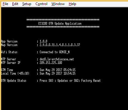

So I am running the OTA example from the SDK and have been following the "CC3200 Over-The-Air (OTA) Update Application Note.pdf".
I encounter a problem whereby instead of storing the downloaded image as /sys/mcuimg2.bin as I would expect from the documentation, it downloads a file and stores it with a random string of characters. After formatting + updating the service pack, then uploading secondary bootloader + mcuimg1.bin, then power cycling I run the application. The application successfully connects to WiFi, downloads an image from the Dropbox app that I created and then reboots. However, instead up running the new image, it fails to load the new image and rolls back to the original.
I am certain that it downloads something as I see a log on the dropbox that increments the download file success counter and a file does appear on the flash. Here is the output when I go to uni-flash and press List File System (note the garbage values in bold at the end):

[01:24:33] INFO: 17 124 20 yes 40 l88humvxursxarmvhdwclx5eh8grzxylflspfdv52m8zuqrqhw
For reference I have created an app on Dropbox, I am using the fourth digit of the NWP version which is zero as the basis of my folder named Vid01_Pid00_Ver0000 and attached below is my output from TeraTerm... after Pressing SW3 is will download the image go into reboot... but then it rolls back to 1.0.0 although I definitely stored 1.0.1 on the Dropbox as per the .pdf instructions.
Can you please assist me?
