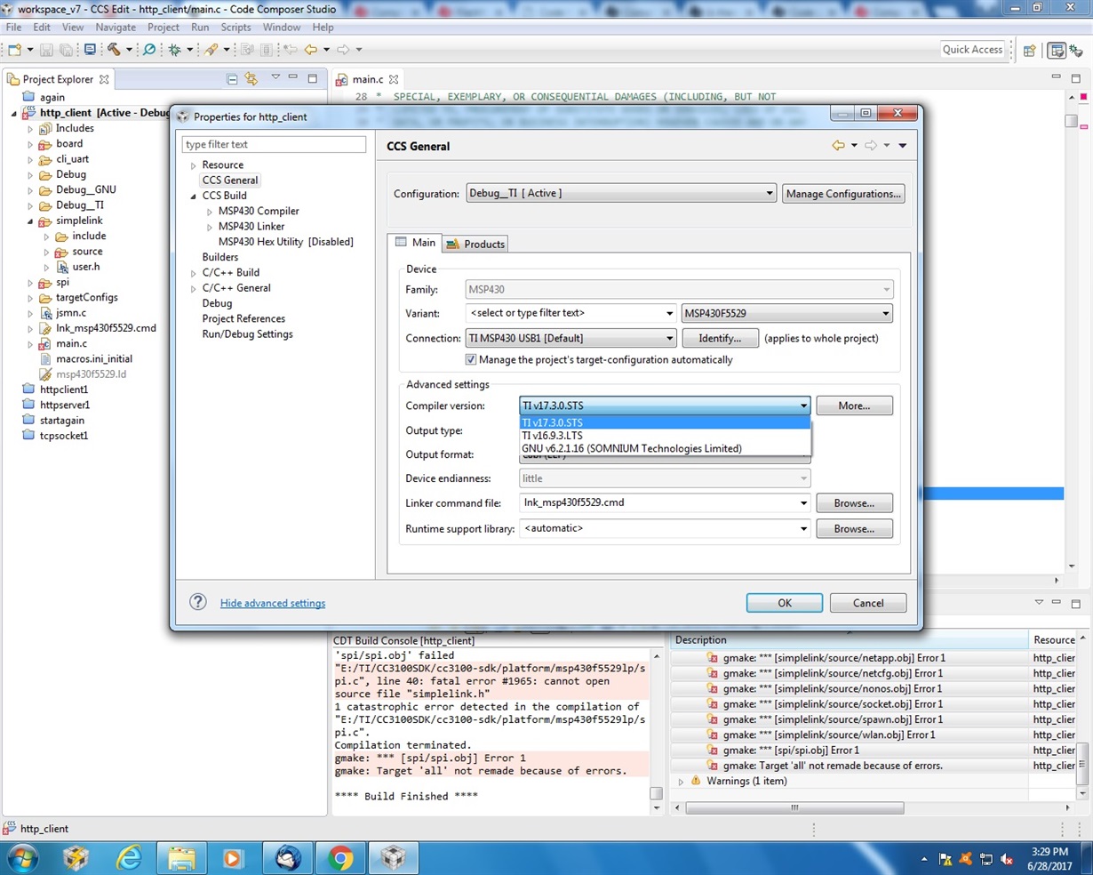

  • Hi Rafel !
    I did as you said, imported  the http_client project and updated the compiler but the version isn't 4.3.8 , rather it is 17.3
    With that i get these errors. Anything I did wrong? Anything there to be modified?

    I see your project seems heavily modified from the original http_client (multiple build configurations such as Debug_GNU, Debug_TI).
    Did you try to install the older compiler to satisfy the project original dependency? You should do that, switch your build configuration to "Debug" (menu Project --> Build Configurations --> Set Active), modify the project parameters according to the top header of the main.c file and rebuild.
    Rafael

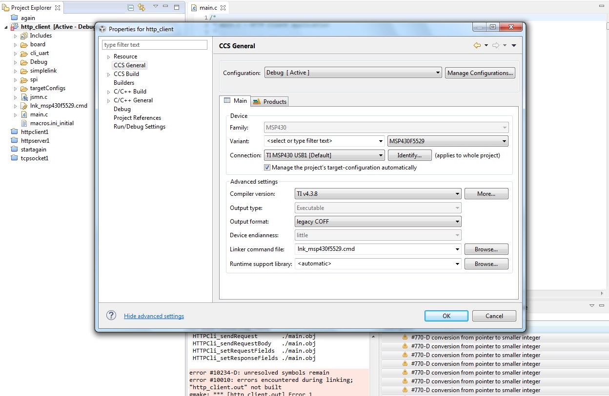

  • Hello Rafael !
    Well, the compiler issue has been resolved. I now have  the version 4.3.8 .

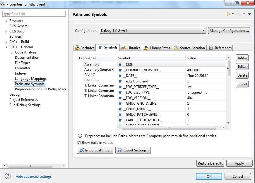

    Now, when I build it, these are the errors.  If in any case preprocessor symbol could be an issue, originally __CCS__ , _MSP430F5529_ , __SL__ , _USE_CLI_ were there . I added HTTPCli_LIBTYPE_MIN . There is no difference in errors with or without my addition.What now ?
    Description Resource Path Location Type #10010 errors encountered during linking; "http_client.out" not built http_client C/C++ Problem <a href="processors.wiki.ti.com/.../10234"> unresolved symbols remain http_client C/C++ Problem cannot find file "http_lib.lib" cannot find file "http_lib.lib" http_client C/C++ Problem gmake: *** [http_client.out] Error 1 http_client C/C++ Problem gmake: Target 'all' not remade because of errors. http_client C/C++ Problem unresolved symbol HTTPCli_connect, first referenced in ./main.obj http_client C/C++ Problem unresolved symbol HTTPCli_construct, first referenced in ./main.obj http_client C/C++ Problem unresolved symbol HTTPCli_getResponseField, first referenced in ./main.obj http_client C/C++ Problem unresolved symbol HTTPCli_getResponseStatus, first referenced in ./main.obj http_client C/C++ Problem unresolved symbol HTTPCli_readResponseBody, first referenced in ./main.obj http_client C/C++ Problem unresolved symbol HTTPCli_sendField, first referenced in ./main.obj http_client C/C++ Problem unresolved symbol HTTPCli_sendRequest, first referenced in ./main.obj http_client C/C++ Problem unresolved symbol HTTPCli_sendRequestBody, first referenced in ./main.obj http_client C/C++ Problem unresolved symbol HTTPCli_setRequestFields, first referenced in ./main.obj http_client C/C++ Problem unresolved symbol HTTPCli_setResponseFields, first referenced in ./main.obj http_client C/C++ Problem #10204-D could not resolve index library "libmath.a" to a compatible library http_client C/C++ Problem #169-D argument of type "unsigned char *" is incompatible with parameter of type "char *" cli_uart.c /http_client/cli_uart line 202 C/C++ Problem #770-D conversion from pointer to smaller integer spi.c /http_client/spi line 132 C/C++ Problem #770-D conversion from pointer to smaller integer spi.c /http_client/spi line 135 C/C++ Problem #770-D conversion from pointer to smaller integer spi.c /http_client/spi line 142 C/C++ Problem #770-D conversion from pointer to smaller integer spi.c /http_client/spi line 145 C/C++ Problem #770-D conversion from pointer to smaller integer spi.c /http_client/spi line 166 C/C++ Problem #770-D conversion from pointer to smaller integer spi.c /http_client/spi line 213 C/C++ Problem #770-D conversion from pointer to smaller integer spi.c /http_client/spi line 216 C/C++ Problem #770-D conversion from pointer to smaller integer spi.c /http_client/spi line 225 C/C++ Problem #770-D conversion from pointer to smaller integer spi.c /http_client/spi line 228 C/C++ Problem #770-D conversion from pointer to smaller integer spi.c /http_client/spi line 247 C/C++ Problem

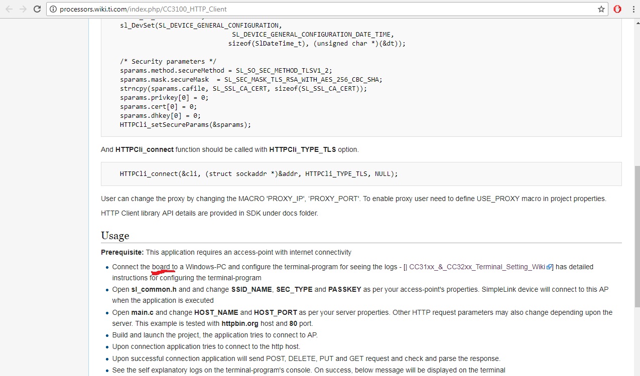

    As per the second link you gave ,
    http://processors.wiki.ti.com/index.php/CC3100_HTTP_Client
    We are asked to connect our 'board' to Windows PC.
    Which board are you guys talking about? Why such ambiguity ?
    Next , as suggested I opened Terminal Setting and I did what was asked to be done for CC31XXEMUOOST in Putty , but no connection opens.
    Please clear this air of ambiguity and suggest some proper guidance by your experts to those who are new to this platform .

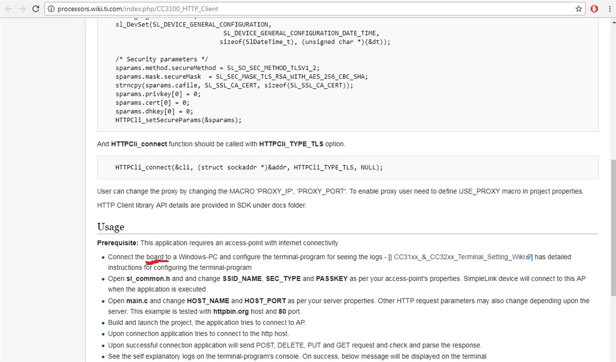

  • Hi Arvind,
    I believe there was some confusion here. The only platform with a HTTP Client example in CC3100 SDK 1.2 is the MSP430F5529 LaunchPad. You must have that host microcontroller in order to run this example without changes to the code/porting to another host driver. In order to execute code using just the CC3100 BoosterPack and CC3100 Emulation BoosterPack, you need to use a SimpleLink Studio example which uses Visual Studio on your PC to act as the host. This is how the CC3100 is different from the CC3200; the CC3100 is just the network processor, so it cannot run anything without a host microcontroller.
    If you want to demo all of the available examples in the CC3100 SDK, I highly recommend you purchase a MSP430F5529 LaunchPad. It is also much easier to start porting from this host driver for development than from SimpleLink Studio.
    Sarah
