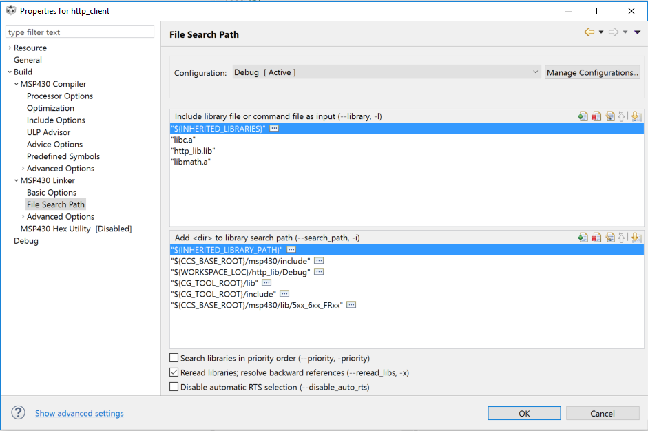

    I noticed from your other post that you resolved the http_lib issue, but you're still having problems with resolving "libmath.a". I would suggest making sure your using the most up-to-date compiler for both http_client and http_lib (Properties>General>Compiler version) and that the output format is ELF, not legacy COFF. I would also try verifying your File Search Path, it should look  like this:

    After looking at your build console again it also looks like you're still linking to an old compiler :
    "C:/TI/ccsv6/tools/compiler/msp430_4.2.7/bin/cl430"
    Make sure you're linking to the correct "tools/compiler" folder
