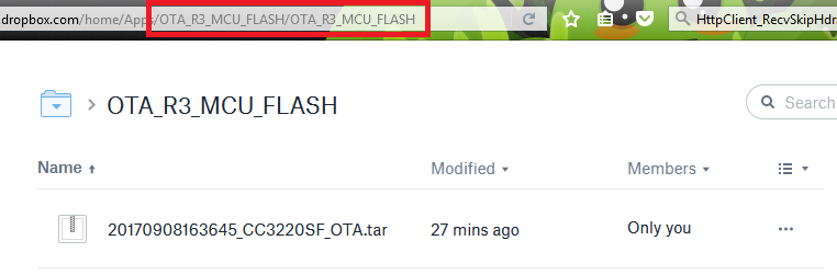

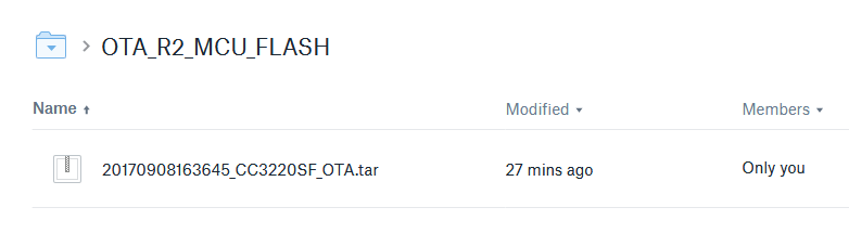

  • I added another one level of deep in apps directory. Now deepest path looks like:
    www.dropbox.com/.../OTA_ARM/OTA_R2_MCU_FLASH/OTA_R2_MCU_FLASH
    I placed my image 20170908163645_CC3220SF_OTA.tar in each folder:
    www.dropbox.com/home/Apps/OTA_ARM/OTA_R2_MCU_FLASH/OTA_R2_MCU_FLASH
    But I still have the same errors (see original post).
  • I think I understand what's going wrong.
    I can't use OTA_R2_MCU_FLASH as application name. Because it can be only one OTA_R2_MCU_FLASH on DropBox servers. So, when I renamed application name to OTA_R3_MCU_FLASH  i got different errors:

    My dropbox currently looks like
