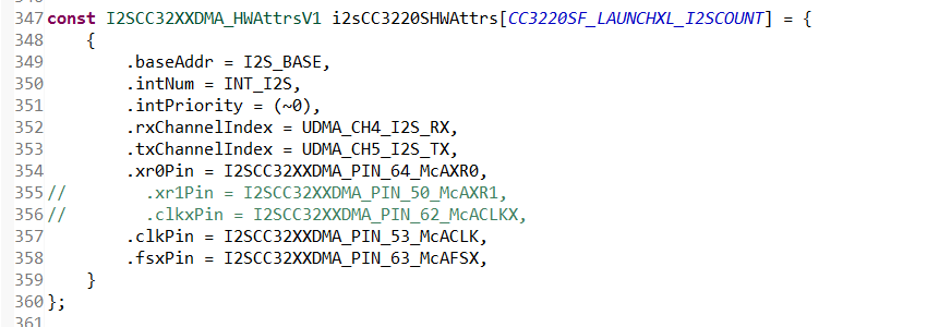

    If you look at the I2S configuration inside the CC3220xx_LAUNCHXL.c, you see we have 5 pins listed here. (xr0,xr1,clkx,clk,fsx). To transmit data out, you only need xr0,clk, and fsx pin. You can Commit out the configuration for ClkX and xr1.

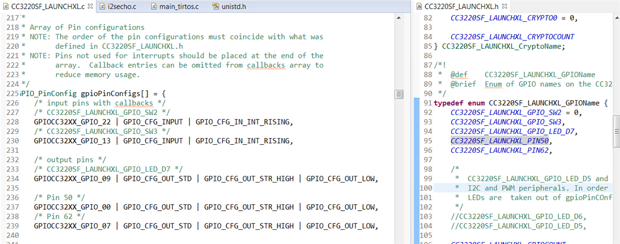

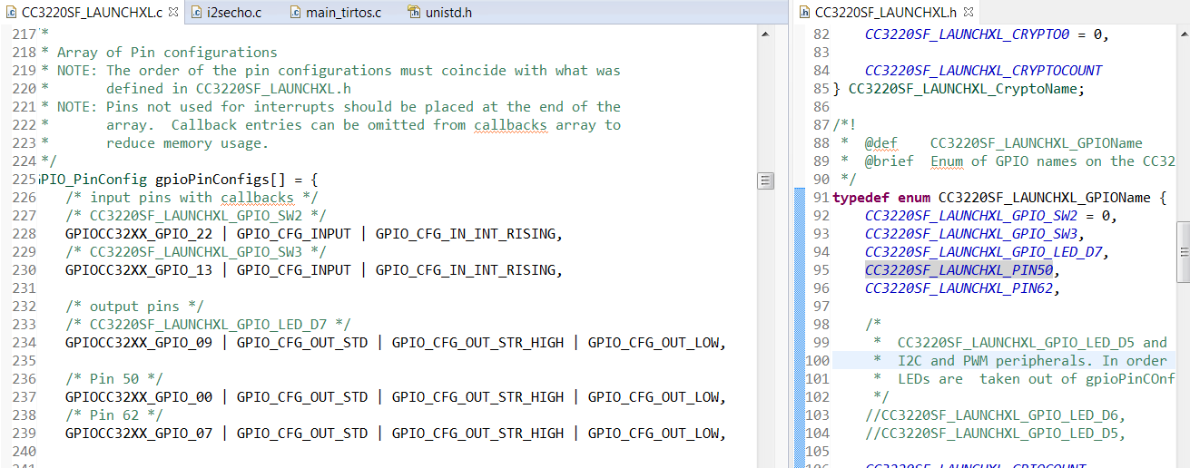

    Now that these pins will not be configured when configuring the I2S, we can add them to another peripheral we want to use them for. For example, I will add them as GPIOs. Add these pins in the configuration in the .c and .h files. The order that you add them to each struct matters, so the first element in one struct/array corresponds to the first element in the other.

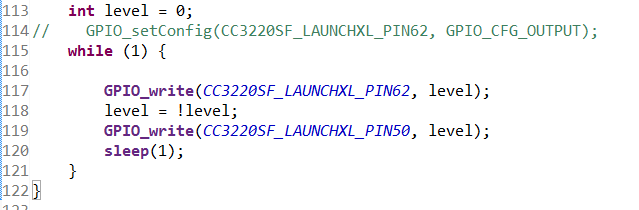

    Now that the configuration is setup, you should be able to go into the i2secho.c and start making a few changes. First thing I did was I wanted to toggle the GPIOs. Since we aren't using the i2s Receive, I went ahead and removed the i2s calls inside the thread, and in the last while loop, I added a GPIO toggle sleep cycle.
    This will now work as intended, but the data the I2S will be sending is nothing, since the TX expected to send the RX coming in from the I2S lines. You can play with the example some more to make it send meaningful data, or just use the example I attached to see it working.

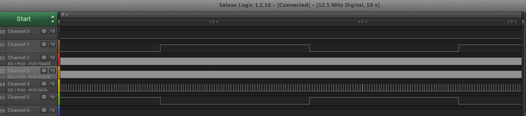

    Here is a Logic Analyzer shot looking at the signals I generated.
    Channel 1 and Channel 5 are GPIOs Pin 50 and 62. There signals are opposites of each other with a period of 1 second. The I2S data is being transmitted, and I made the buffers first element have a value so I could see the spike when a new buffer was being sent.
    This should be how to accomplish what you guys wanted, but let me know if you have any questions! :)

    I figured out the problem here. Our system was actually hanging when trying to send I2C data. The reason is that when McAXR1 and McACLKX are commented out they get assigned 0x000. Then the I2S_open() initialize all 5 pins, and 0x000 is setting PIN_1 to PIN_MODE_0 which is incorrect as we need it to be in PIN_MODE_1 (0x100). The solution here is to assign McAXR1 and McACLKX the value 0xFFF, similar to what the UART is doing with UARTCC32XX_PIN_UNASSIGNED:
    #define I2SCC32XXDMA_PIN_UNASSIGNED   0xFFF
    I2SCC32XXDMA_Object i2sCC3220SObjects[CC3220S_LAUNCHXL_I2SCOUNT];
    const I2SCC32XXDMA_HWAttrsV1 i2sCC3220SHWAttrs[CC3220S_LAUNCHXL_I2SCOUNT] = {
            .baseAddr = I2S_BASE,
            .intNum = INT_I2S,
            .intPriority = (~0),
            .rxChannelIndex = UDMA_CH4_I2S_RX,
            .txChannelIndex = UDMA_CH5_I2S_TX,
            .xr0Pin = I2SCC32XXDMA_PIN_50_McAXR0,
            .xr1Pin = I2SCC32XXDMA_PIN_UNASSIGNED,  //I2SCC32XXDMA_PIN_60_McAXR1,
            .clkxPin = I2SCC32XXDMA_PIN_UNASSIGNED, //I2SCC32XXDMA_PIN_62_McACLKX,
            .clkPin = I2SCC32XXDMA_PIN_53_McACLK,
            .fsxPin = I2SCC32XXDMA_PIN_15_McAFSX,
    Your example was helpful as it showed me that the I2S driver was capable of operating with only 3 pins.
