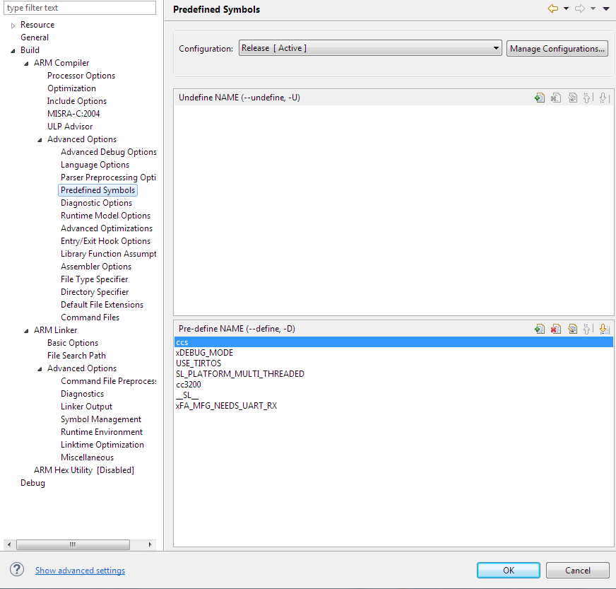

    I have commented the clear screen command. But can you tell me how to disable the NOTERM compile flag? And where can I see the library trace file?
    Shlok...
  • Shlok,
    You need to go to your project properties and find the following section labelled "Predefined Symbols". Make sure NOTERM is not in the list at the bottom. I believe TI support is asking for this to be done for the 'ota' project, but maybe you want to make sure all related projects do not have 'NOTERM' defined.
    Josh
  • Thanks Josh,
    NO TERM is not added in the list there.
    But I still have the same problem.
    Also nothing new is being displayed on the serial terminal.
