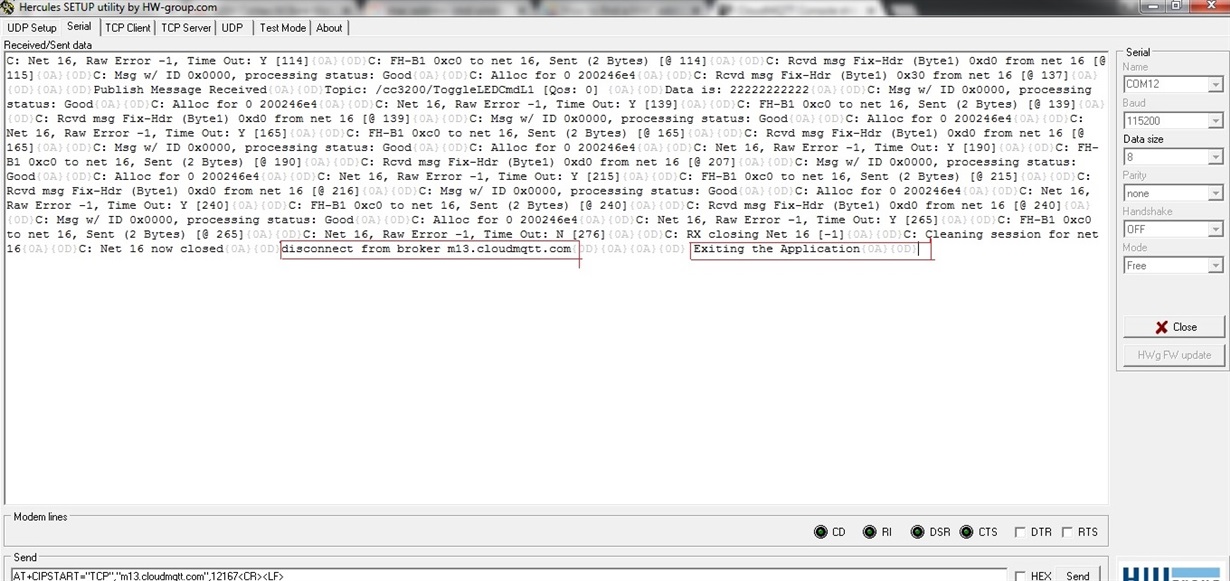

i have been testing client_mqtt example on launchpad and it is connected to cloudMQTT broker .....it works fine but after some time like half an hour connection with broker gets closed ...........i want this connection forever .........i don't wanna lose incoming data to cc3200.......how can i overcome this problem??? i have attached screenshot of terminal window..........please check the message shown in red box .........also i get a message on cloudMQTT that "client stopped"
  • Seems like this is due to a time out.
    This is likely an issue on the broker side. Please check the logs there.

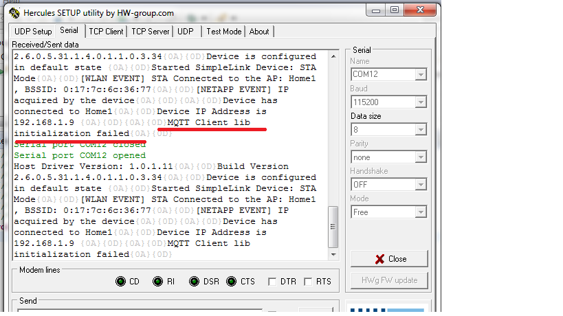

    i changed my board and on new board above issue is solved dont know how...... but now i want to send data that i receive from cloudMQTT to uart0 but sample code shows so many messages on console window while code is running that i don't want ...........so i commented most of the UART_PRINT(" ") lines in my code but still i am getting some messages......i have attached screenshot of terminal please check that out...........i don't want these messages to be forwarded over uart because i have connected zigbee to UART0........
  • These are debug messages from the mqtt library.
    If you don't need to see those messages, please try changing Mqtt_Client in main.c:
    /* library configuration */
    SlMqttClientLibCfg_t Mqtt_Client={
    0,
    TASK_PRIORITY,
    30,
    false, // disable additional debug info
    0 // no function pointer to print function (UART_PRINT)
  • hi toby
    i made changes as you suggested but i am getting above message.............and also i don't want to disable uart0 completely because i  should be able to get messages published from cloudMQTT on my terminal .........i just want to disable ping packets response that i get after every 25 seconds....
  • Ok, here is another thing to try (according to this post: e2e.ti.com/.../565140 ):
    - Change your Mqtt_Client back to the original
    - Import mqtt library into CCS ( in C:\ti\CC3200SDK_1.3.0\cc3200-sdk\netapps\mqtt\ccs )
        - Note: Do not copy the project into workspace
    - Add pre-defined symbol DEBUG_NET_DEV
    - Rebuild mqtt, then rebuild mqtt_client
  • if i import mqtt library into CCS (in C:\ti\CC3200SDK_1.3.0\cc3200-sdk\netapps\mqtt\ccs )
    it throws me below error
    gmake: *** No rule to make target `C:/ti/CC3200SDK_1.3.0/cc3200-sdk/netapps/mqtt/platform/cc3200_platform.c', needed by `cc3200_platform.obj'. mqtt Unknown C/C++ Problem
  • Please rename cc3200_platform.c to cc32xx_platform.c.
    You can find this file in mqtt/platform
