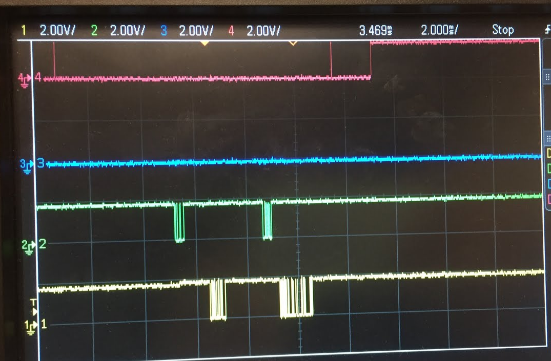

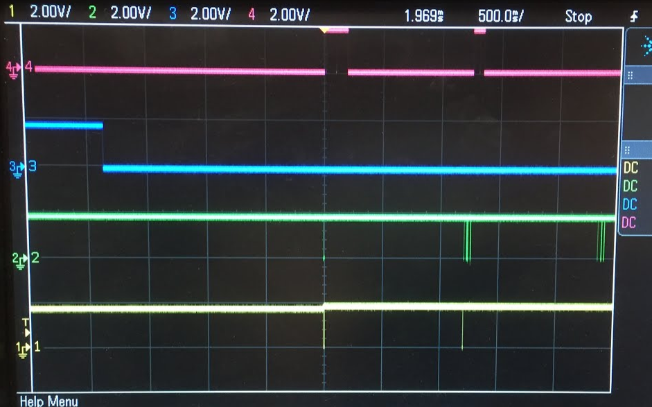

  • The error is:
    Error: Could not get the script version from the controller. TIBTS_Get_Script_Version() Result: -14.
    The AM3358 seems to be communicating to the WiLink.
    signals from AM3358 perspective, from bottom: 1 yellow RX, 2 green TX, 3 blue CTS, 4 pink, RTS
