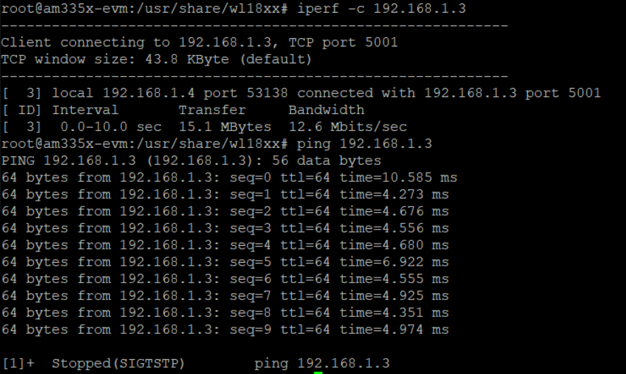

3. Ping and Iperf test result
If seems like one of the devices has to be the server and the other has to be the client to do iperf testing

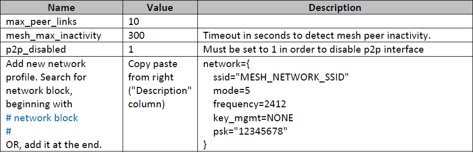

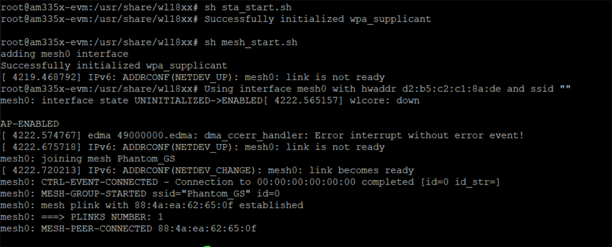

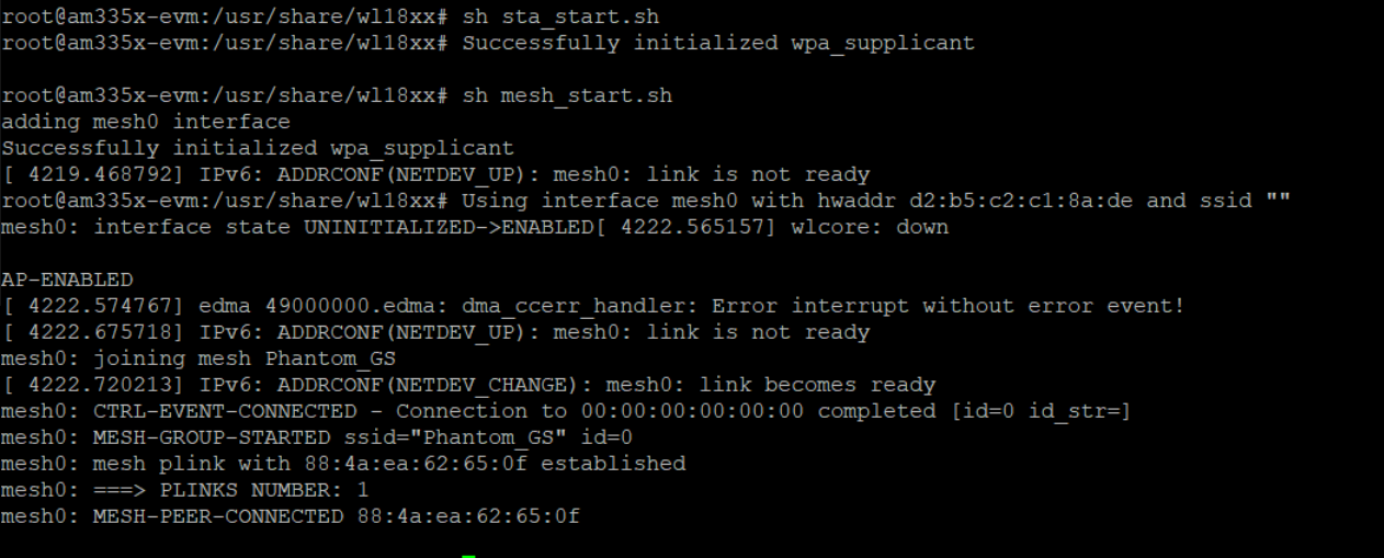

4. Mesh + STA mode
I am trying use to Mesh + STA mode
According to Section 5.3.2.1, I have to use the wpa_supplicant configuration file (I assume I have to change the wpa_supplicant, similar to what I did on mesh_supplicant)
Here is what I got:

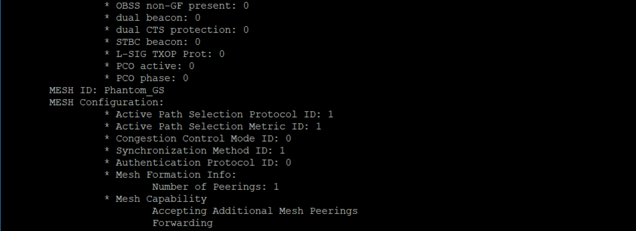

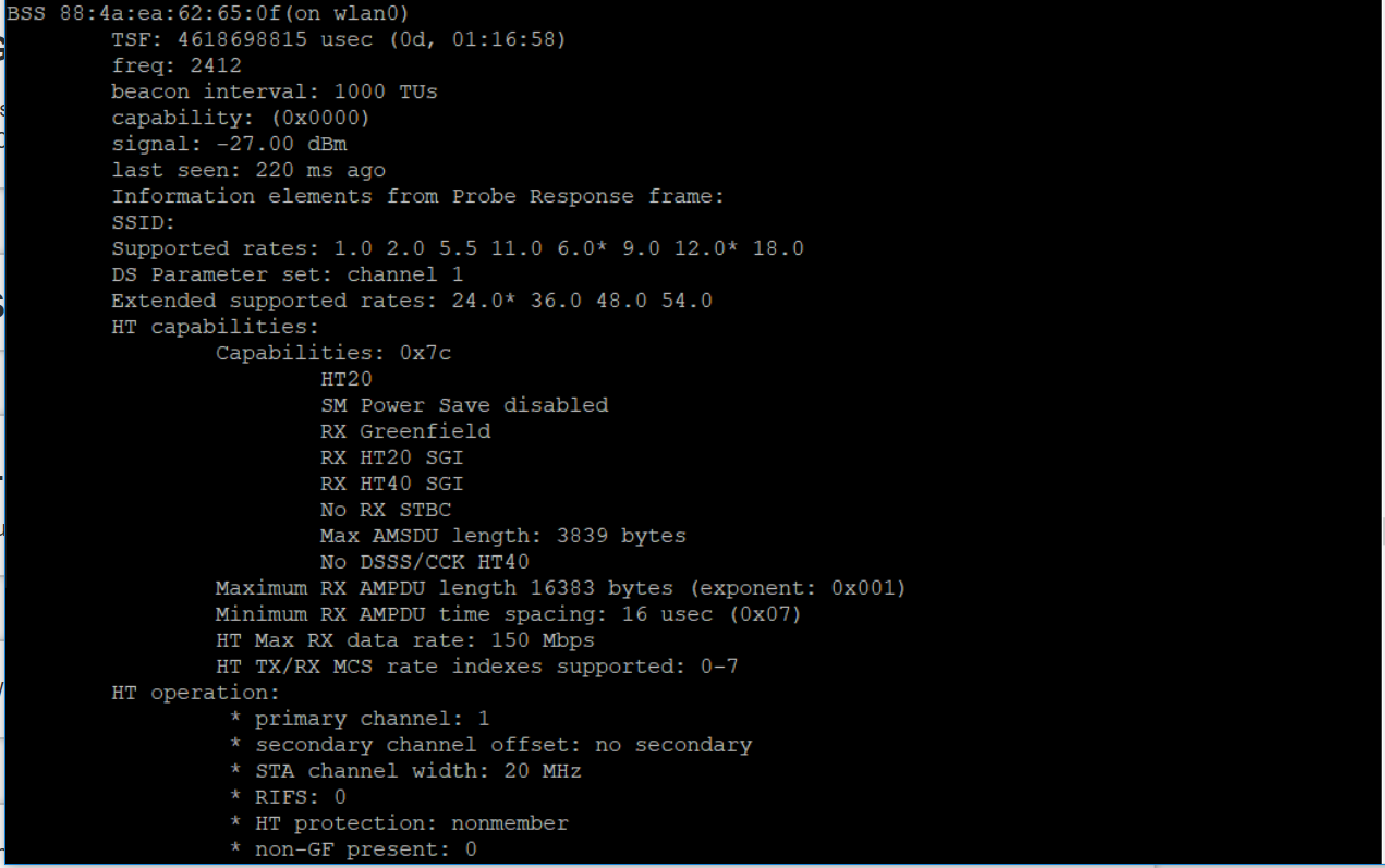

5. Display of Hidden SSID when mesh0 is up
After I tried Mesh + STA. I can view the Wi-Fi networks using iw dev wlan0 scan but, It shows no SSID defined but it has MESH ID as Phantom_GS which I defined in the mesh_supplicant configuration file.

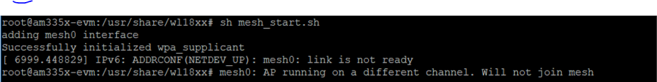

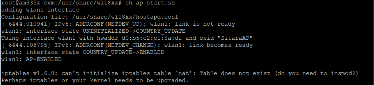

6. Mesh + AP
I followed 5.4 and I got this output:
I assume I have to install some apt and upgrade the kernel? I do not want to install apt and upgrade kernel before verifying the changes with reply.
And run mesh_start.sh
It seems I have to make some additional modifications between AP and Mesh modes.
I look forward to hearing sage advice before continuing further.
