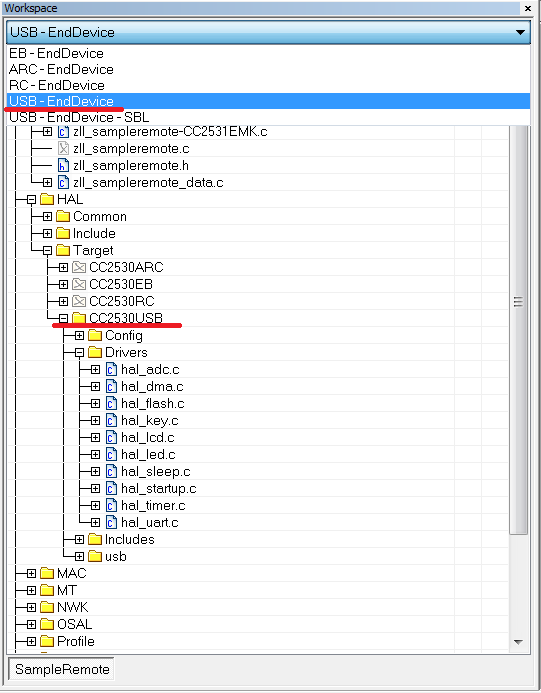

  • Sorry, I made the assupmtion that you wanted to run the SampleLight project on the CC2531 dongle. I now see that you want to add PWM support to the remote project running on CC2531 dongle.
    Yes, what you say is correct  just copy hal_timer.c from:
    Z-Stack Lighting 1.0.1\Components\hal\target\CC2530PMP4712
    To:
    Z-Stack Lighting 1.0.1\Components\hal\target\CC2530USB

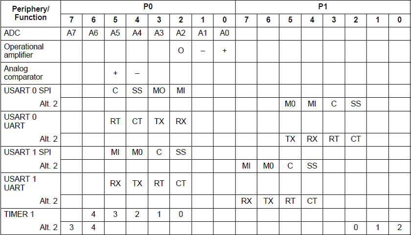

  • You can find this information in the CC2530 users guide (http://www.ti.com/litv/pdf/swru191d). Table 7-1 "Peripheral I/O Pin Mapping" shows timer 1 channel pins, for the primary and alt. 2 (used when PWN_ALT is defined) mappings.
    Regards, TC.

    According to the Table 7-1 and the above code in hal_board_cfg.h
    If I don't define PWN_ALT2 in SampleRemote project , the PWM output pin of channel 1 , 2 , 3 and 4 is the P0_3 , P0_4 , P0_5 and P0_6 respectively.
    So...If I set the PWM dutycycle of channel 1 for Timer 1 is 50% by using halTimer1SetChannelDuty (HAL_T1_CH1, 500); in SampleRemote project -> zllSampleRemote_Init function
    Q1 : And then I can see the waveform from P0_3 via oscilloscope when CC2531 USB Dongle power on , is it correct ??

    I copy the hal_timer.c from CC2530PMP4712 to CC2530USB.
    and add the following code of red color in hal_board_cfg.h in CC2530USB.

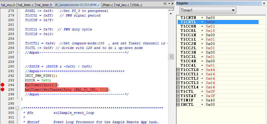

    But I didn't get 50% duty cycle on oscilloscope...did I do something wrong ?
  • Maybe soething is over writing the configuration. To test this your could call  INIT_PWM_PINS before HalTimer1Init(0);
    regards, TC.
  • No...it doesn't show anything.
    Does there has the other code that I didn't add , like ENABLE_LAMP or the other??

    But I have try to add the following code in the end of zllSampleRemote_Init.
    INIT_PWM_PINS();
    HalTimer1Init(0);
    I still did not seeing the wave form , and I don't know why...
    So I had to modify register settings to see the wave form.
    OK , If I use the halTimer API , should I do something about ENABLE_LAMP in zllSampleRemote_Init?
    I see the DISABLE_LAMP define in SampleLight in hal_board_cfg.h , and use in zll_sampleLight.c.
    Or the priority setting of P2DIR is not set to 0x80 , so I can see the wave form ?
    I didn't see the priority setting of P2DIR in sampleremote.
  • It could be that on the CC2531 dongle something is setting P2DIR incorrectly for the PWM to work, so yes include this. Also check if there are any other reg differences that can explain the issue. In IAR debug mode you can do view->registers to see the register settings.
    /TC.
  • It work successfully , it show the 50% wave form after I add the P2DIR = 0x80.
    I set the break point and see the value of registers.
    But I didn't know why the T1CC1H is 0x00 ?
