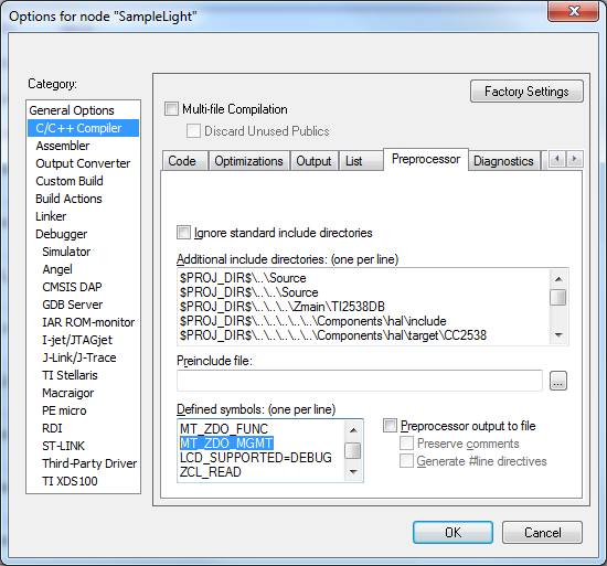

  • I took a look at your sniffer log and the LQI response has a status = NOT SUPPORTED, this is the reason why you are getting a response but you are not able to see any information about the end device. To fix this you need to define MT_ZDO_MGMT.
    Go to your project options then to "C/C++ Compiler", select the "Preprocessor" tab and in the "Defined symbols" box type MT_ZDO_MGMT and then press OK.
    After doing that you will need to rebuild the project and flash your boards again, and this should fix your problem.
    Let me know if you have any other questions.
  •  Hi Hector,
             But i already defined MT_ZDO_MGMT in all three devices.
