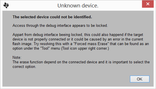

I've connected it to Flash Programmer 2 to delete the flash and I get the following message.
I tried Forced mass Erase but after initiating access to the target I get the following failure messages:
Create XBAL Object failed: Board reset before connect failed
Failed to create device object.

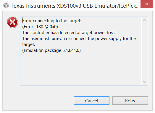

When uploading the program in Code Composer 6 I get the following message.
Anyone know what I can do to get the board functional again?

  • Hector,
    Looks like the EM is only getting 1V. When I remove the EM and test the power going to the EM interface it's 0V. I also checked on a functioning board and I get 3.3V with and without an EM.
    Is this common? I don't remember even touching the board so I don't believe static discharge is the cause.
