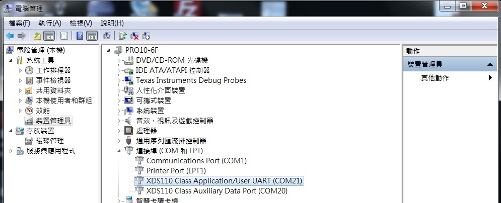

Basically my problem is that I am getting no serial output from the cc2650 sensortag when connecting using the Debugger DevPack. Wondering if anyone have tried this successfully, or have any hints.
In Windows7 I see the USB/debugger come up as two COM ports (Application/User UART, and Auxiliary Data Port),  but I am getting no output when listening to these ports with 115200/8/N/1. I am also able to reach the node and program it via the Flash Programmer 2 - so the connection seems to be fine. Tried mainly with the cc26xx-demo (I see frames being TXed in capture so I know the SW is running). I get same silence when trying in linux. I am using the drivers which were installed in the SmartRF Tools directory when installing latest Flash Programmer 2.
