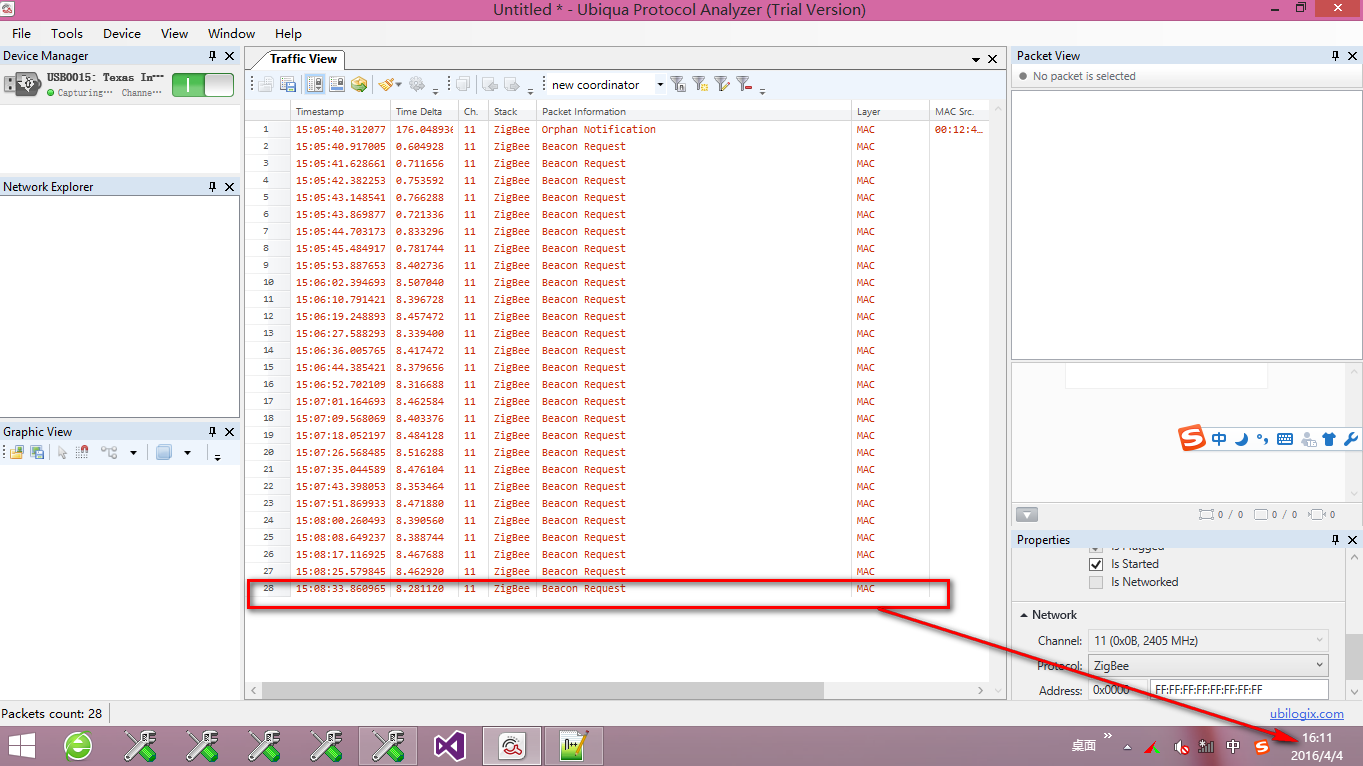

  • Hi Leo Cahalan, thank you for your post !
    i am using the zstack 1.2.2 in CC2530. and i have a similar issue .
    but my issue is that the device execute the REJOIN_BACKOFF case in ZDO_REJOIN_BACKOFF EVENT,
    But  the device state is alway keep DEV_NWK_DIS.
    do you find that?
    SET UP:
    when ZED join network , power off the ZC , so the ZED  running  rejoin scan === rejoin backoff  === rejoin scan
    sometimes  my issue happens!!!
    this issue happen both 1.2.2 and 1.2.2a
    CHANGE ITEM TEST:
    I have change the rejoin scan period  from 10s ,20s ,3 minutes  ,5minutes`~~~~~
    rejoin backoff  30s, 30minutes  and so on.
    it seems that long time period will easy to call this issue , ( just base on the result of test again and again,)
    BR!
  • Hi The Seven,
    Try implementing my changes as shown above. If I recall correctly, the device being stuck in DEV_NWK_DISC is a side effect of the same issue.
  • Hi JasonB
    if the device stuck in DEV_NWK_DISC , after the next rejoin cylce coming , does it could rejoin the network ?
    br!
  • I would suggest you to test Jason's patch first and if you still see problems, you can report it.

    Log : 5187.456.rar
    it shows that After 15:08 there is not more any beacon request until 30minutes later, although rejoin backoff period is only 30minutes
    i have some questions :
    1.  when “strange case”  happen ,what can i do  for you?
    2. is that OK change  the default rejoin period as  what i want (just like 30minutes or 3minutes)?
    3. is that matter set up 10 ZED to test the rejoin logic at the same time  same place?
    BR!
