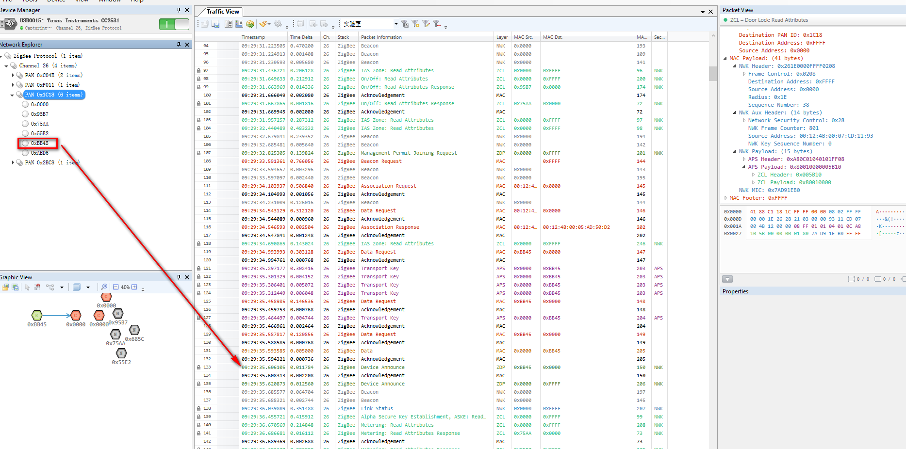

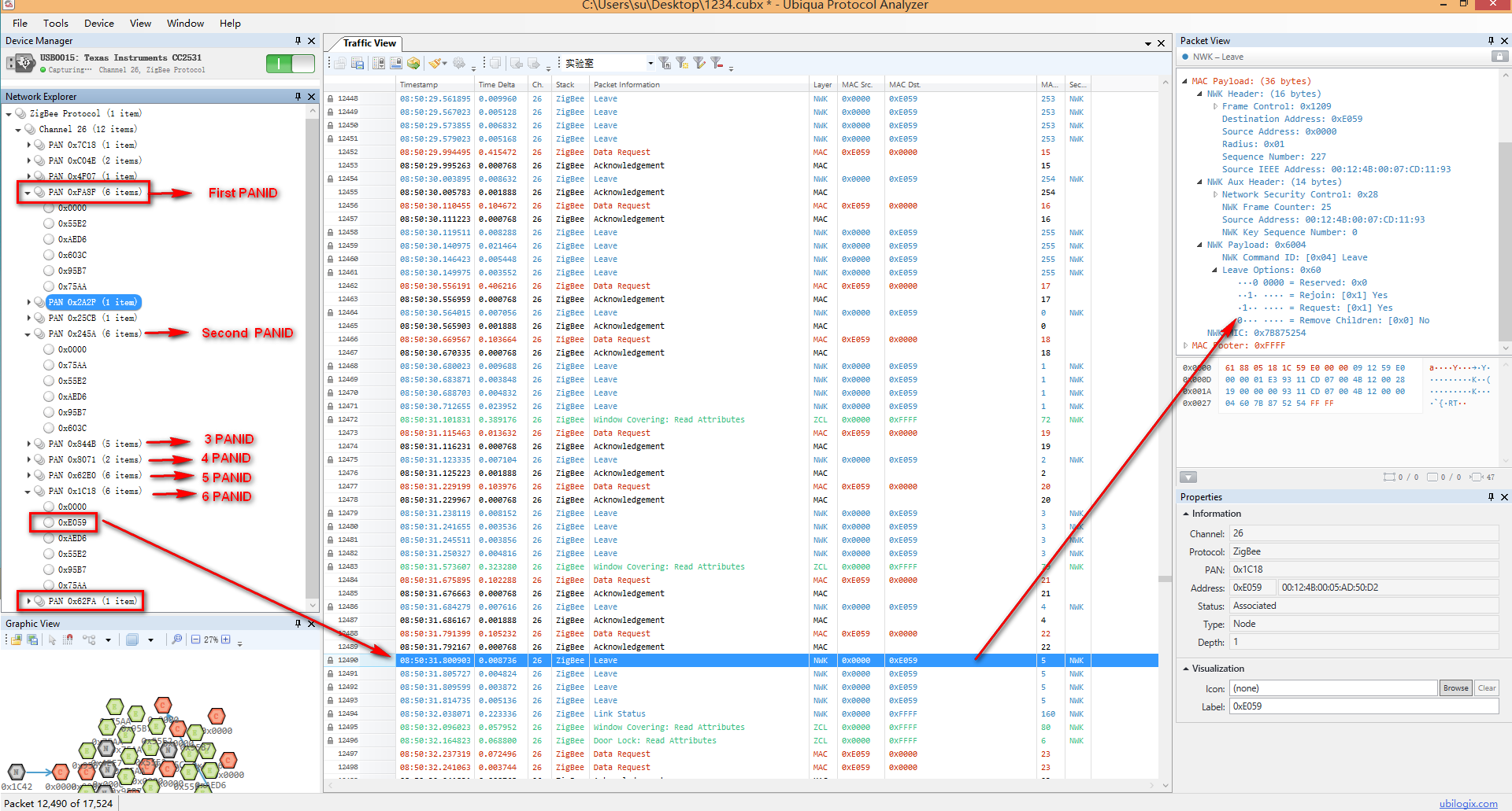

when i test 6 times , i found that one of the POWER_SAVING ZED could not rejoin the network (others are OK)
The ZED short address is 0xE059 at the fifth time “restart”
when the ZC finish the sixth time “restart” ,  the 0xE059 could not rejoin the ZC anymore ,
i saw that there is a lot of   “Leave” CMD (which option include  rejoin bit 0x01 and request bit 0x01 ) from ZC to 0xE059。
here  is the log :1234.rar
(Ps:  We could search the 12324 ,it  is the begin of the issue  happen )
and i  wait a long time,  This  ZED could not rejoin the network .
so  i  power off the ZED and then power on,  but  it also  could not be  rejoin ,
then  i  turn on the permit join of the ZC,  i saw that  the ZED could rejoin success by  using a new short address 0xBB05
so  what is the cause of this issue?
why does othere  ZED could rejoin success ???

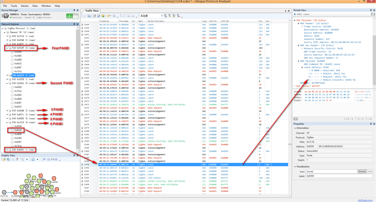

  • Hi JasonB
                I  found something strange phenomenon happen 。
                i do not let the ZC doing frequently “restart” , just let it here 。

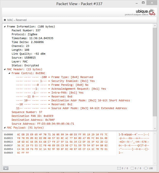

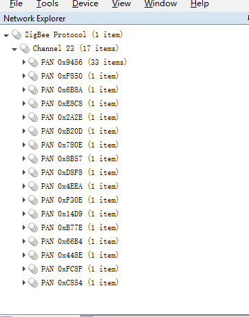

                those ZEDs will sending the IEEE request to the ZC every 45s, and there are 16 ZEDs link to ZC。
                i saw  that the there are 16 PANID in the log although there is only one ZC actually ,within  24hours Testing。
                log:CHANGE PANID.rar
    i  was so curious about why does  ZC changing the PANID  so frequently, although it had enable the NV_RESTORE。anyway i have got the log about PANID changing as above:
    you can see the 337  log , ubiqua shows it is Reserves , i have not any idea about this MSG means?
    is that  matter with  the issue about  ZED could not rejoin the network until  the ZC turn on the permit join???
    and  i always found that there is also beacon while  ZED sending  beacon request, but  ZED could not rejoin success until  ZC turn on permitjoin !!!!
    BR!

  • In response to packet #337, that appears to be junk data picked up by your packet sniffer, unrelated to your own network. You can see the RSSI (link quality) is very low, which means that whatever is sending that signal is much farther away from your sniffer than your network devices. This is normal, I see packets like that in my own testing occasionally.
    The PANID list above only shows 1 network containing more than 1 device, PAN 0x9456. My guess is that the other networks you see listed in your sniffer log are present from junk data packets picked up by your sniffer, similar to packet #337 from above. In that CHANGE PANID log you can see that packet #337 corresponds to PAN 0x65E9, and there are no other packets corresponding to that PAN in that log. Do you have the log for the image you posted above with all the different PANIDs?

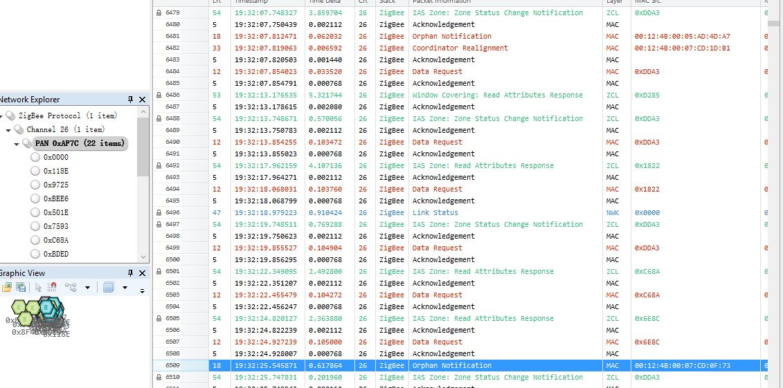

         As  you know ,  HA1.2.2a Using a new mechanism of Child Aging.
        i saw  that  there is  a Orphan Notification  and  Coordinator Realignment  。
       but  when the issue about  ZED could not rejoin  happens, i found  that  there is  a orphan notification without coordinator realignment !
      (PS: the Link Quality  is good , so  you  don't need to question whether ZED is far  from  the ZC or not  )
        Q1:
        so i questions if the ZC  forget to  sending the coordinator realignment , does it  would  cause the  ZED disconnect the network ?
        Q2:
        What   would casus the ZC forget to  sending the coordinator realignment ?

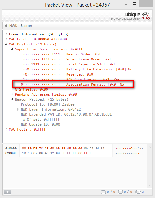

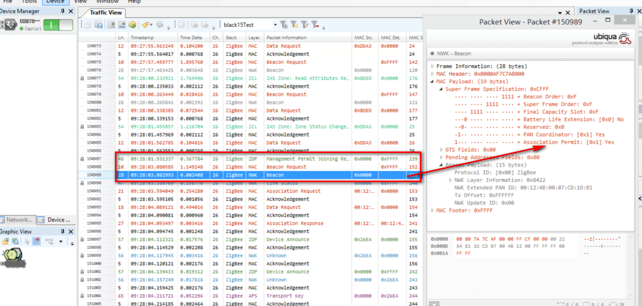

               when ZED being sending the beacon request, and could not rejoin  the network,
               i  compare those  beacon which  send  from ZC  , and  i have found that they were different  between  before turn on the permit join and after  turn on permit join。
              Before  Turn on the permit join   Beacon association permit bit  is set 0:
             After  Turn on the permit join   Beacon association permit bit  is set 1:
           Q3 :
               ok, we  just don't care why does  ZED disconnect the network although link Quality is  good 。
                but  why does ZC  send  the beacon  without   enable association permit bit ?(that causes  the ZED could not rejoin  network directly)
                and that   is  why  i tell you  every time  this  issue happens , i  turn on  the permit  join  and then ZED is ok to rejoin。
              so it seems that NV_RESTORE does not work !!!!is  that right ????

  • here is the  log :orphan&coordinator realignment issue.rar
       in  6509 item,
       you can see a ZED sending orphan notification  and  there is not coordinator realignment ,and then it  turns to send beacon request
       and i let it  to scanning  all the night , and  it always could not rejoin 。。
       in  145638 item,
        i turn on the permit join  , it could rejoin success 。。。
    BR!

    Q1:
         i found that the ZED sends the orphan notification  and there is not  coordinator realignment  and ACK, then it going to sending beacon request, but it could not rejoin the network although there is a beacon come from the ZC, until i turn on the permit join on ZC side。
           please refer below log:   item  6059
           6443.orphan&coordinator realignment issue.rar

         I compare  the beacon of  the ZC  and found  the below  info:
         rejoin success ZED =====》  no matter  the beacon  do not enable the association request , it could rejoin the network,
         rejoin failed  ZED  ======》   just sending  the beacon request, if the beacon had not enable the association permit join。
          so  i think that the problem  maybe  caused by the ZED side (rejoin  part ),  it seems that  the  ZED have not notice it have already joined the network。
          when receive a beacon without enable association permit, it could not sending the rejoin request。
          so  should we  update  the NIB into the NV again by ourselves   when the device join the network???

  • Hi JasonB
         I  had  test  this  issue all the night  and  just  set the ZEDs as normal as it was( just  joining the network  and  sending a MSG to ZC every 45s) .
        at  this morning , i found  there were  more than 5 ZED was lost network  and  could not rejoin although there is a beacon  response for  the beacon request。
         when  this  issue  happen(sends beacon request), i found  there is not more Coordinator Realignment  and ACK
         2588,
         10699,
          11111,
          44195,
           43516,
           Log is here :
        but  i always have a  question about  the Rejoin 。
        ZED could  auto rejoin the network  when it had  joined , but  now it seems  this function  is failed 。。。
        is there any  bug  on the state- mechanism ?

  • Hi JansonB
    when this issue happen, i using debug mode to detect its state ,
    i set a break point in the ZDO_beaconNotifyIndCB()
    and i found that pNwkDesc is diffierent with pBeacon, so the "found" is set as flase
    and then i found the ZED could not run into this function
    // check if this device is a better choice to join...
    // ...dont bother checking assocPermit flag is doing a rejoin
    if ( ( pBeacon->LQI > gMIN_TREE_LQI ) &&
    ( ( pBeacon->permitJoining == TRUE ) || ( _tmpRejoinState ) ) )
    as i saw this the log , the LQI is good and bigger than gMIN_TREE_LQI, permitJoing is FALSE.
    so it depends on the value of _tmpRejoinState.
    but i search all the ZAPP.c i had not found anywhere set the _tmpRejoinState as FALSE.
    why does it could not run into above " if function"
