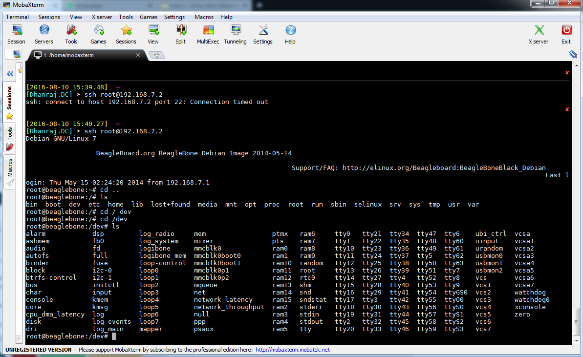

  • 1. Do you enable ENABLE_MT_SYS_RESET_SHUTDOWN in your compile option.
    2. When you plug CC2531EMK to bbb and do "ls /dev", do you see ttyACM0?
  • 1) YES  I enable ENABLE_MT_SYS_RESET_SHUTDOWN in compile option.
    2)I don't see ttyACM0.please find below snapshot.
    DC

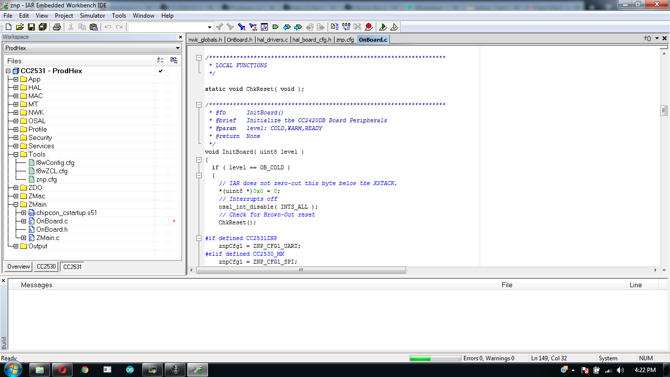

  • Which project do you use to build ZNP for CC2531 dongle?
  • cc2531 prod hex.
    you can see blow snapshot.
    DC
  • If you plug CC2531 dongle to your desktop, do you see virtual com port emulated?
  • no, it shows USB device not recognised!!
  • also yellow led on cc2531 dongle doesn't glow.
  • I suggest you to do debug.
  • i have rebuilt znp using DEBUG ,its working .
    IS there any functional difference among DEBUG,prod-test,prod-SBL,prod-hex??
    DC
  • To know the differences between those four configurations, you can refer to Z-Stack User's Guide - CC2530 ZNP at e2e.ti.com/.../0184.Z_2D00_Stack-User_2700_s-Guide-for-CC2530-ZigBee_2D00_PRO-Network-Processor-_2D00_-Sample-Applications.pdf
