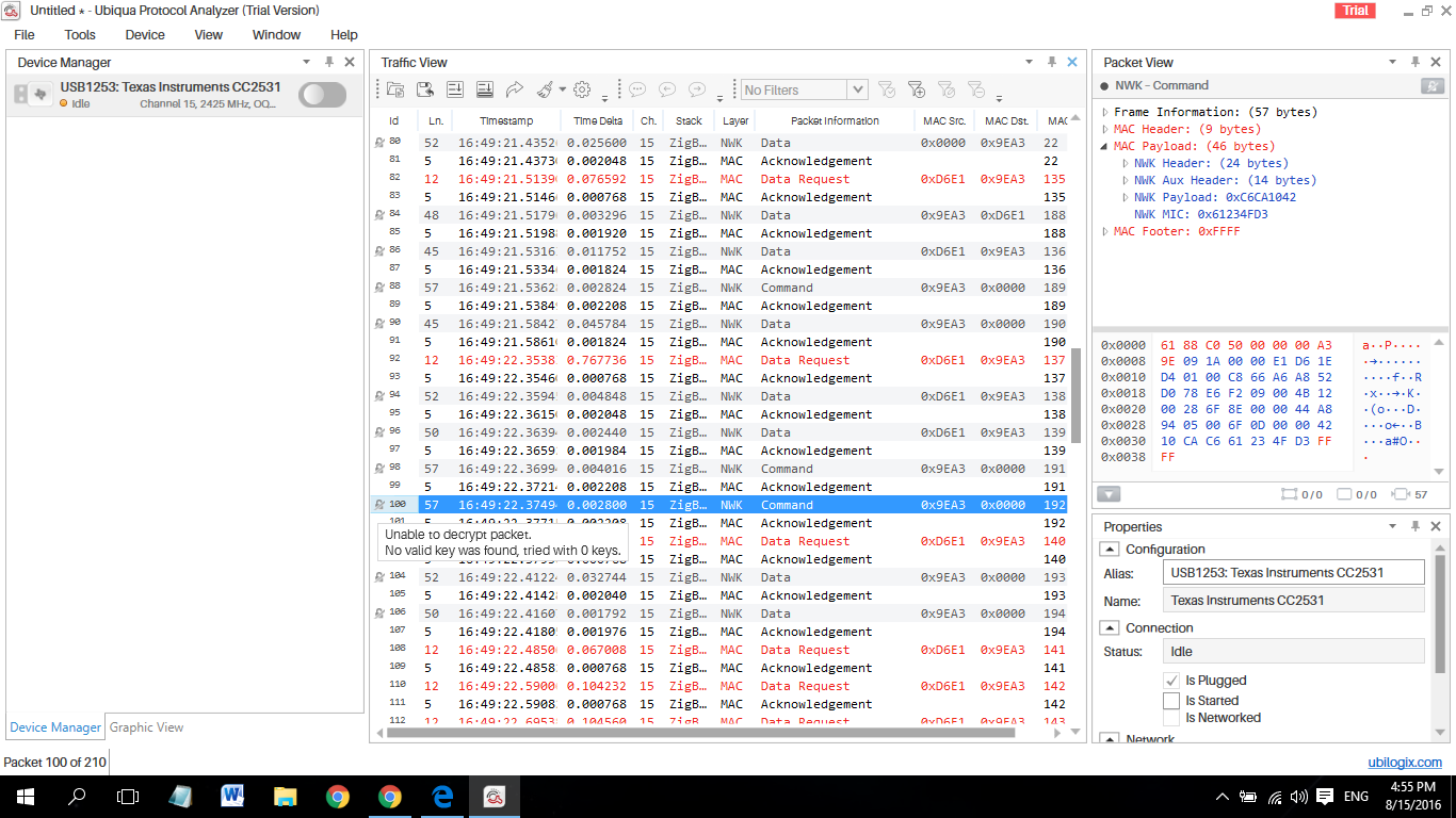

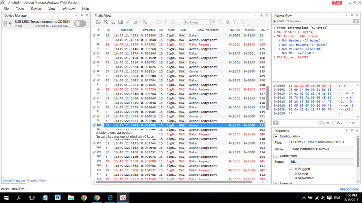

"How do I make it so the Smartthings app will immediate pick up the status of the device when I manually toggle the device form the on to off."

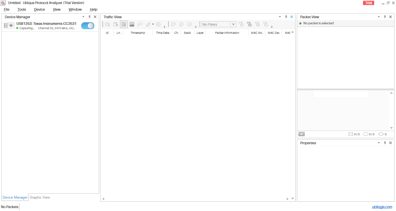

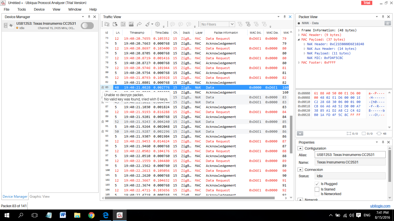

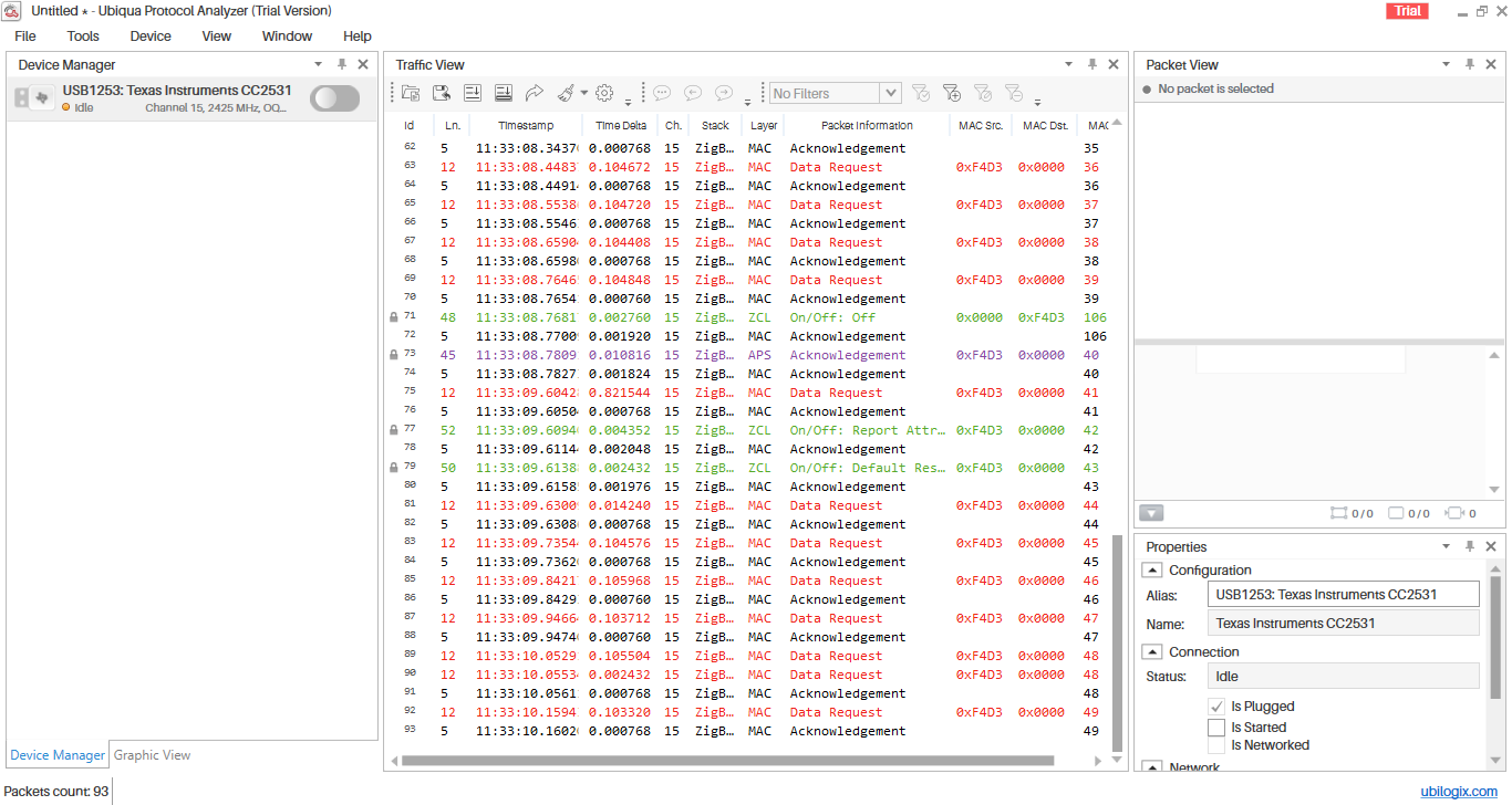

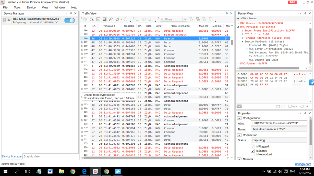

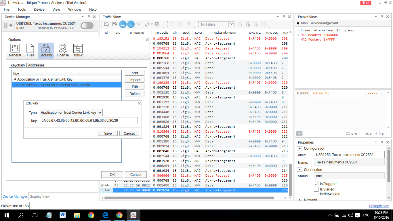

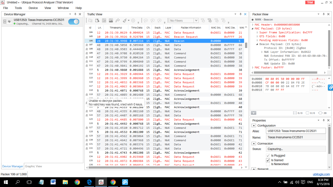

I've been trying to work with the example SampleLight program and everytime I manually toggle the CC2530 EndDevice from on to off, the Smartthings hub/Coordinator isn't able to pick up the EndDevice's current status. I had tried the below code, but the Smartthings app only updates the status of the device when I press the refresh button, instead of automatically updating the status. I've asked the Smartthings community, but I haven't gotten any answers from there. My post there is: community.smartthings.com/.../22. I believe there is more to fixing the IAR code than there is with the Smartthings code.
Example of my problem here:
1) I manually turned the switch off and the Smartthings app still says it's on.
2) I either press the refresh button to get the device status of off or I press the app's off button to match the device's current status.
3) The I repeat the setup over and over again which is a lot of hassle.
