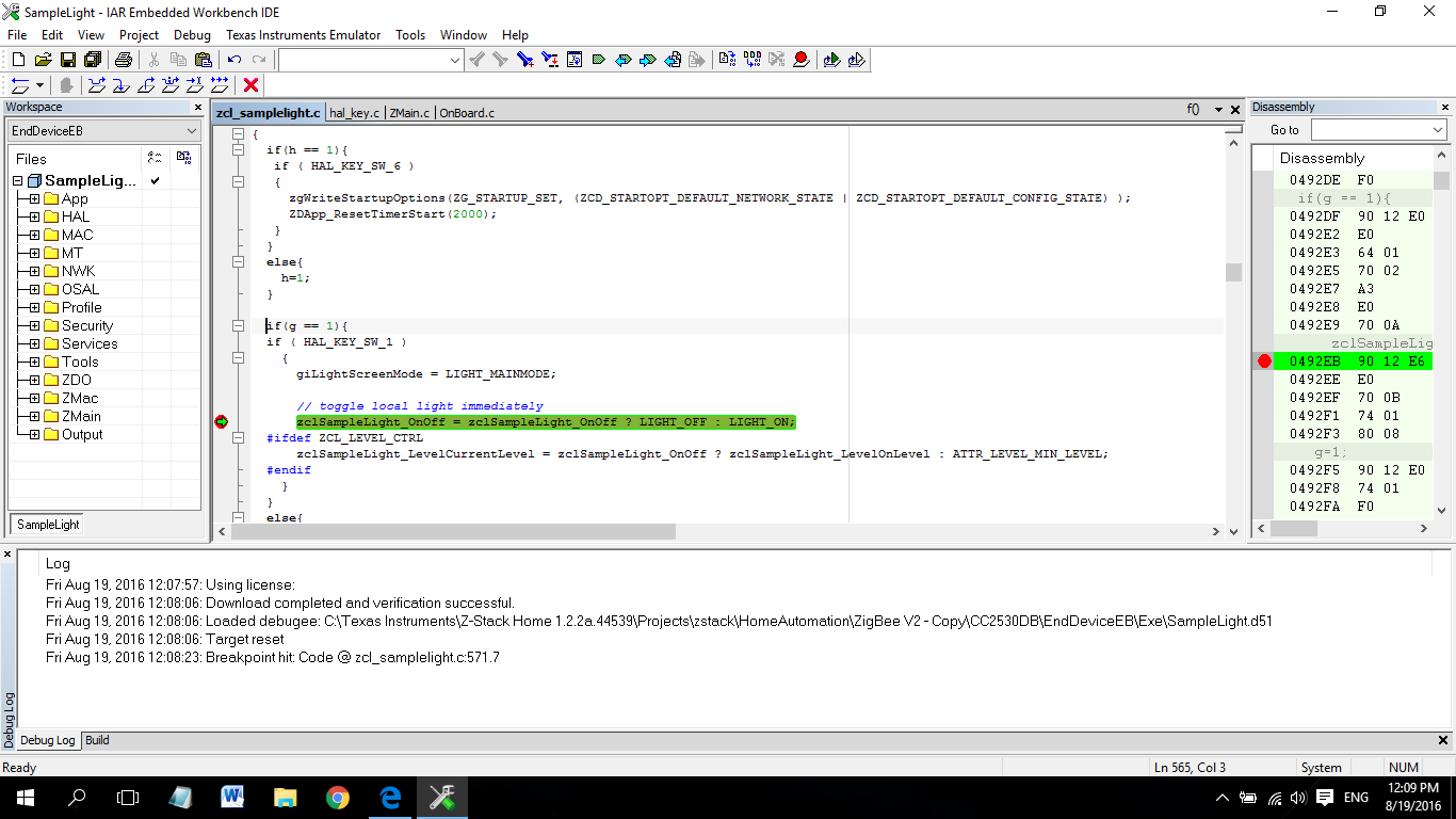

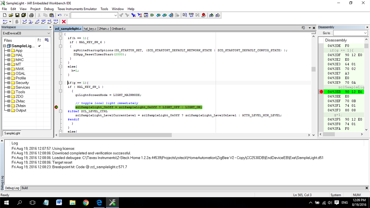

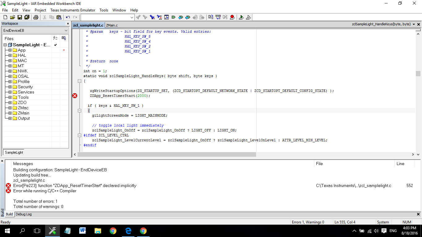

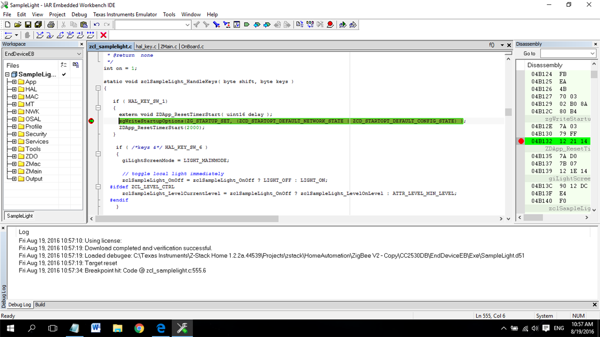

How would I program my CC530 board to be reset from all coordinators. Right I have a CC2530 connected to 1 coordinator. I wanted to connect the CC2530 to the 2nd coordinator, so I unpowered the 1st coordinator without properly disconnecting the CC2530. I powered the 2nd coordinator and tried to connect my CC2530 to the 2nd coordinator. However the CC2530 doesn't connect to the 2nd coordinator and still has its mind set on the 1st coordinator. How would I reset the CC2530 so that it would forget about all of its connections with previous coordinators? I am currently using SampleLight in IAR 8051. I would very much appreciate any helpful replies.
