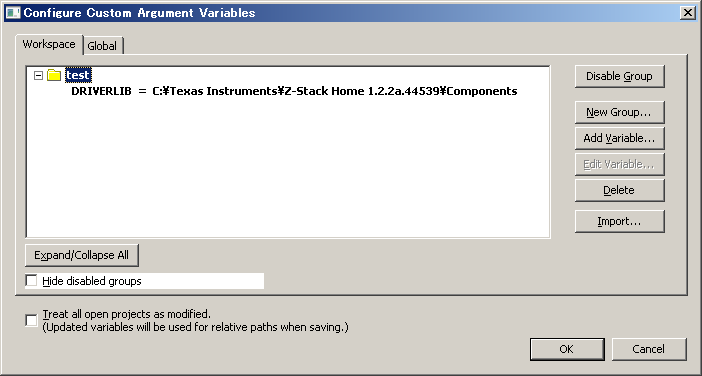

Hello, could you please advise to build a sample project?
I'm aware of the original thread https://e2e.ti.com/support/wireless_connectivity/zigbee_6lowpan_802-15-4_mac/f/158/t/489018
I'm trying the same thing and hit to a new error.
- I installed IAR-EW 7.40.2.8570.
- I Opened  C:\ti\simplelink\zstack_home_1_02_02a_44539\Projects\zstack\HomeAutomation\SampleSwitch\CC26xx\SampleSwitch.eww
- And trying to build one of the projects - "ZStackCore".
>> [Result]  The first error was a missing of DRIVERLIB.
/cfs-file/__key/communityserver-discussions-components-files/158/05-IAR740-SampleSwitch-ZStackCore-01_2D00_NoChange-_2D002D00_-Missing-DRIVERLIB.txt
- I defined the symbol on Tools >> Configure Custom Argument variable .. (Although I think this is already a wrong way..)
>> [Result]  The second error was a missing of "hw_memmap.h".
/cfs-file/__key/communityserver-discussions-components-files/158/05-IAR740-SampleSwitch-ZStackCore-11_2D00_Defined-DRIVERLIB-_2D002D00_-Missing-hw_5F00_memmap.h
>> I could not find the location of the file.
