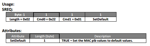

I have created next sequence of MT commands:
FE 02 22 01 01 DE (this message I have to send twice to get response FE 01 62 01 00 62, by the way, by documentation it should be FE 01 62 00 00 63)

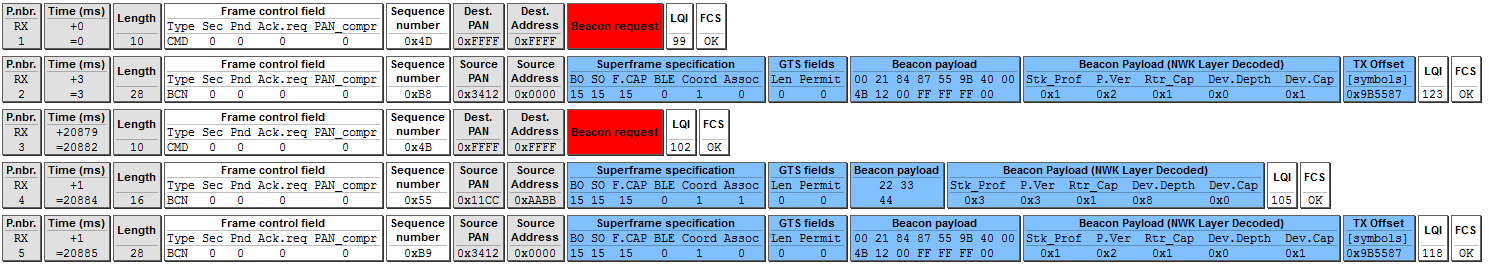

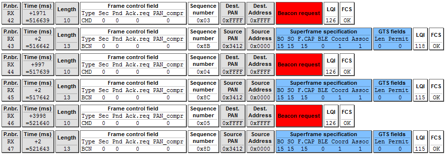

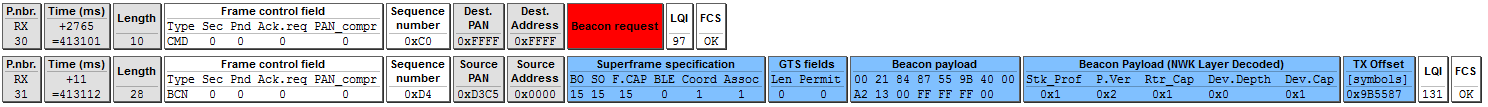

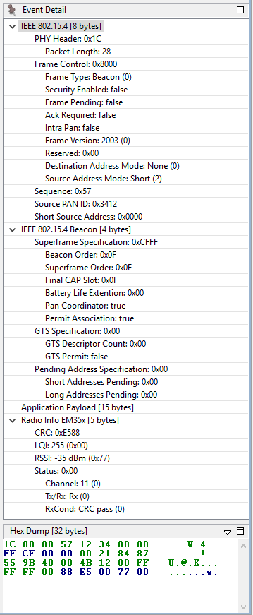

However, using my sniffer I don't see that coordinator actually started: no response to Beacon Request message from another device in all channels.
What am I doing wrong and how to fix this?
