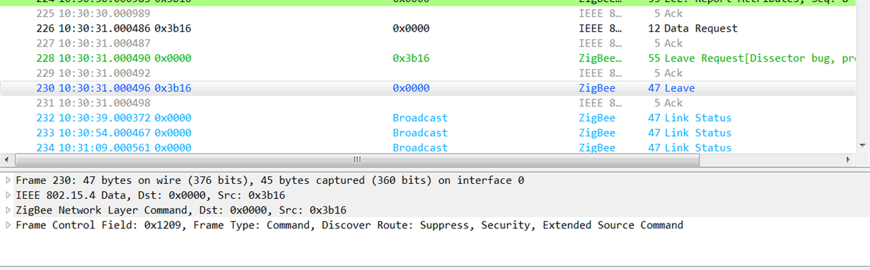

CC2538: Leave indication is not shown in z-tool with z-stack 3.0?
Part Number: CC2538
Other Parts Discussed in Thread: Z-STACK
I'm using the cc2538dk and I'm running the sample switch of z-stack 3.0 and I have configured my application as coordinator. I'm working with z-tool to send MT commands and I'm analizing the trafic with wireshark. I have been testing this version de z-stack and in I would like to do a question about the behaviour of when an ED to leave the network. I'm removing an ED with two ways: sending a zdo_mgmt_leave_req to the ED and removig it from the own ED. In both cases the leave indication which is sent from the ED to the ZC (ZC and PC connected via usb) is not sent by the usb to the PC so is not shown in z-tool. In addition the ED is not removed from the AssocDevicesList until the end_device_timeout expires.
king regards,
