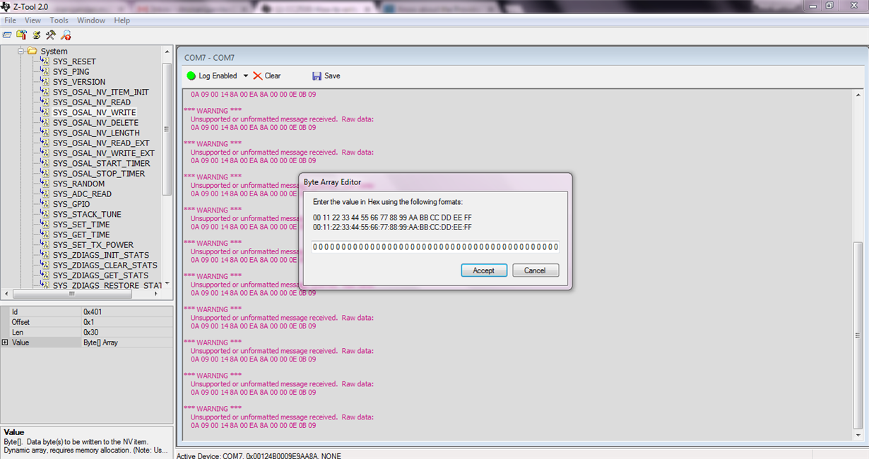

 I am trying to write data to NV RAM using SYS_OSAL_NV_WRITE API in z-tool, But with that I am able to write only 128 bits of data. If I want to write more data into same nv_id, how to do it?
Consider I am going to write 10 IEEE addresses in same NV_ID....
Right now in nv_id 0x0401, I am able to write upto 128bits.(0xAA, 0xA4, 0xE9, 0x09, 0x00, 0x4B, 0x12, 0x00, 0x97, 0xA4, 0xE9, 0x09, 0x00, 0x4B, 0x12, 0x00) from z-tool using API.
But I want to write more addresses in same NV_ID, as below..
0xAA, 0xA4, 0xE9, 0x09, 0x00, 0x4B, 0x12, 0x00, 0x97, 0xA4, 0xE9, 0x09, 0x00, 0x4B, 0x12, 0x00,0x2A, 0x3F, 0xA4, 0x0A, 0x00, 0x4B, 0x12, 0x00,0xAA, 0xA4, 0xE9, 0x09, 0x00, 0x4B, 0x12, 0x00, 0x97, 0xA4, 0xE9, 0x09, 0x00, 0x4B, 0x12, 0x00,0x2A, 0x3F, 0xA4, 0x0A, 0x00, 0x4B, 0x12, 0x00

  • Can you show me how you use SYS_OSAL_NV_WRITE?

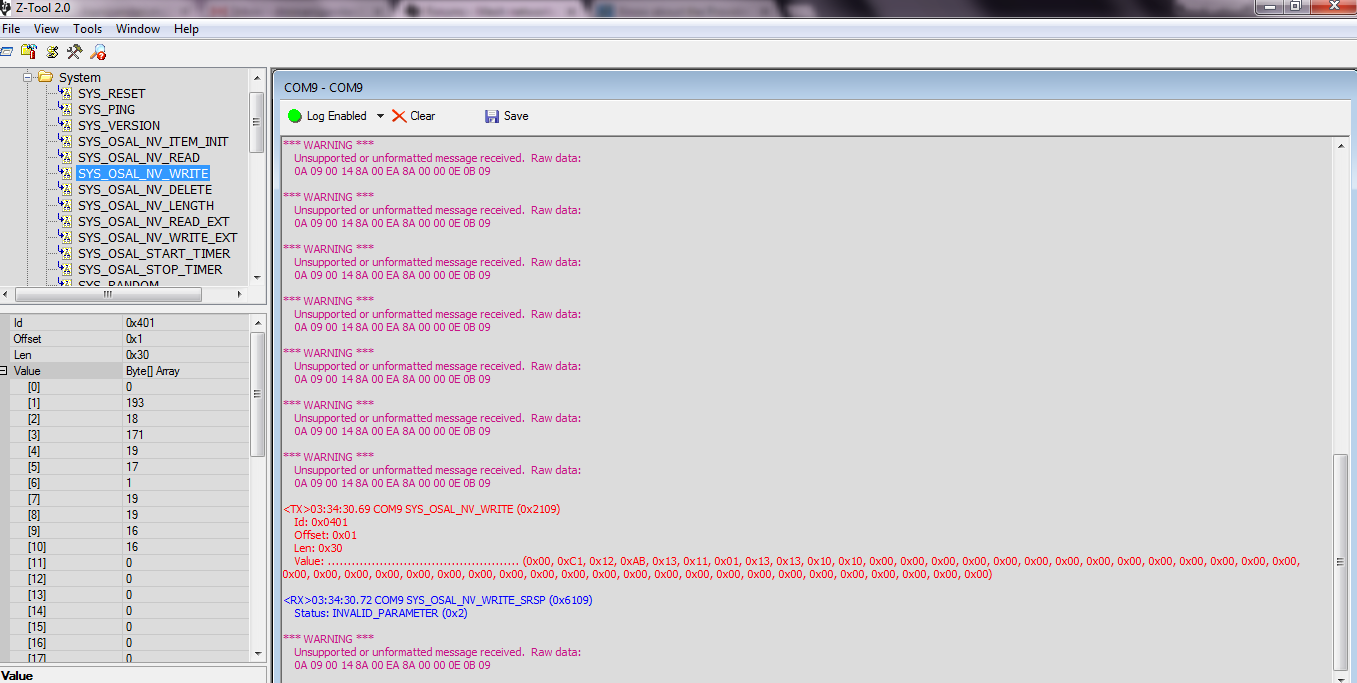

  • I have given nv_id as 0x0401, offset=1, length= 30, and corresponding data.
    if the length is beyond 16, then it is giving INVALID PARAMETER .
  • You input length as 0x30 which is 48 bytes in decimal so do you input 48 bytes data?
  • Actual data size of IEEE address is 8 byte. If I want to store multiple IEEE addresses means I have to increase the length right?
    If it is not correct way means how to write more addresses.
  • Yes, you can increase length when you want to store multiple IEEE addresses.
  • But I am not able to write that much data. It is taking only 16bytes. That is the issue..
    Can you check this?

  • Hi Arun,
    Make sure to initialize the item as the total length of the Nv Item, otherwise if you initialize it as 16 bytes, you will not be able to write further than that.
    I did the following test on ZNP device CC2531, you should be able to get the same on your device.
    Initialize item as 250 length, only providing 16 bytes to initialize it

    Note that the Nv pages are 2k, which means that in theory you should be able to write Nv items up to 2k, in practice you do not because the pages requires some headers and bytes to manage the nv memory, nv memory can only be written from 0's to 1's (or vice versa, I'm not sure), which means that changes in the values often means that the Nv memory needs to be reset, for small items the Nv manager uses the remaining space in the same page and duplicates the nv item with the new values, marking the old item. When the complete page is used an Nv operation will trigger to reset the complete page. If you use Nv items large enough and change the value of these items often you will trigger these pages reset pretty often which might affect the performance of your device, for which is advice you have relatively small nv items (256 bytes are a good number, perhaps even smaller to make it fit in a single nv read operation from MT interface).
    Hope this helps!
