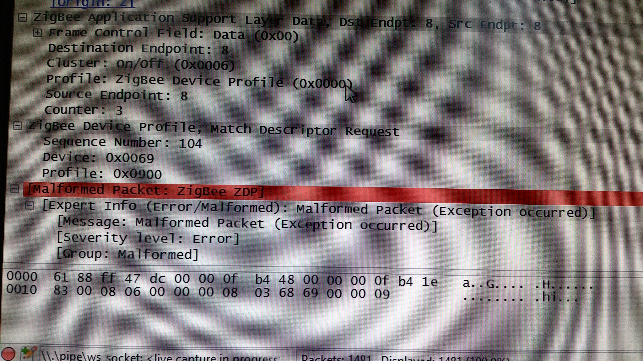

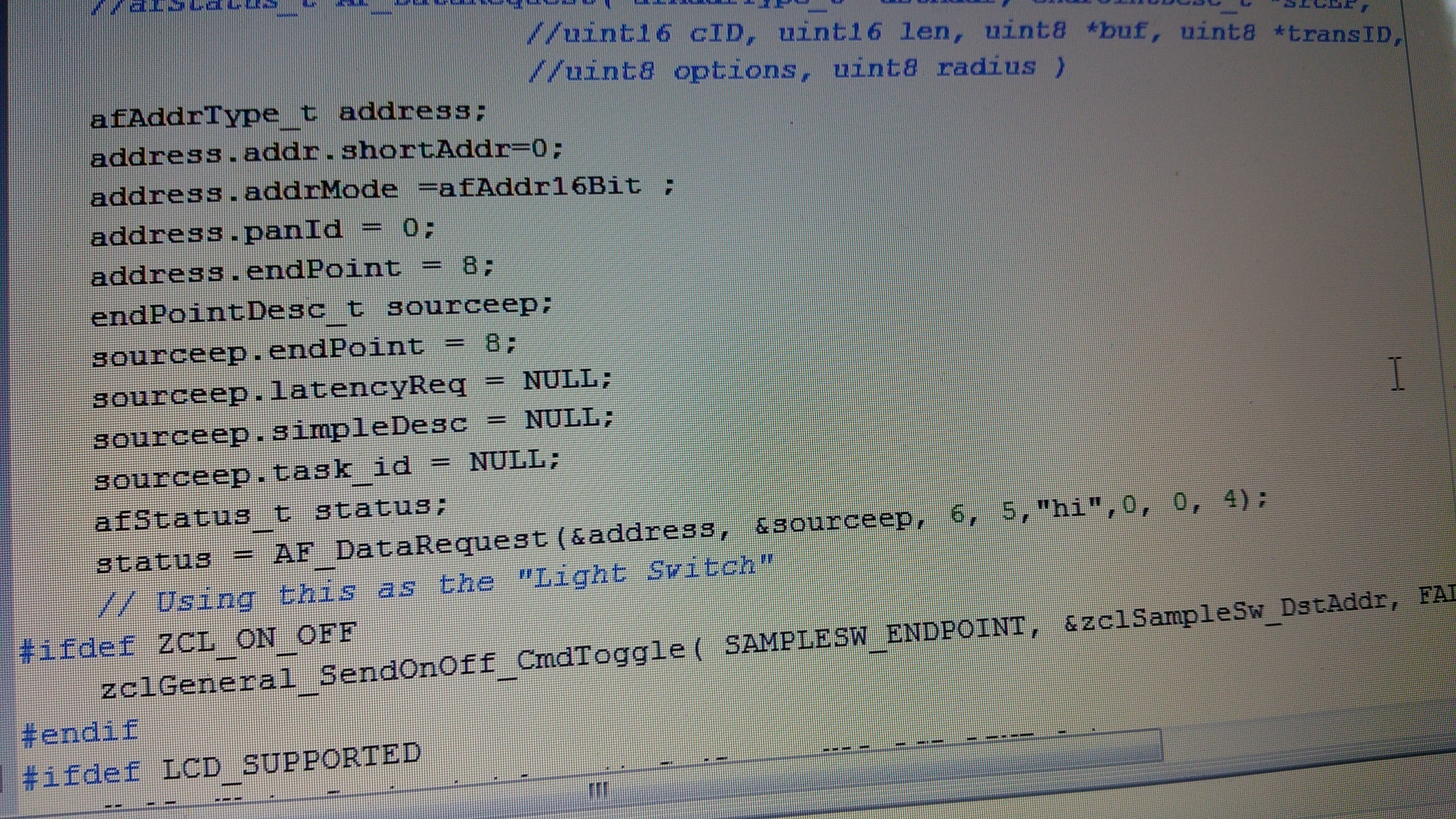

I'm using z-stack 1.2.2 home automation, sample light sample switch. I would like to send data without binding. I can send data using short address 0x0000 of coordinator and the packet I can see on sniffer.
How to receive this ota packet on coordinator side without binding?
