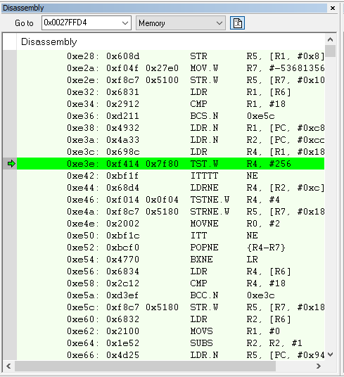

Hi guys,
I have a problem with a CC2538 evaluation module (I am using the SmartRF 06 evaluation board and the on board XDS 100v3 debugger).
My issue is the following: when I enter a debug session the microcontroller doesn't go to main() but is executing code in the ROM area (which is, I suppose, the bootloader code). However the backdoor for the bootloader is disabled in my code and seems to be disabled on the chip, as you can see below:
The PC points to these addresses when I start a debug session :
I tried the reprogram the chip several times, and I always have the same problem (but it was working before the problem occurred), thanks to the SmartRF flash progammer, I tried to erase the chip and I also tried the "Force Mass Erase" option and I reprogrammed the chip after but I still have the same result.
The exact same code is working very well on another evaluation module (with the same evaluation board).
Is anybody have a solution ?

    Obviously the flash erase and program operation are successful (I am still able to read the flash and I see correct values, all 0xFF when erased and consistent values when programmed). But the device stay stuck in the bootloader ROM code when I start an debug session (and is not working obviously when no debugger is attached).
    Is there really no solutions ?
    I have some fears about integrating this chip in our design if the reference design and the programming tools are not reliable.
    Please, provide us a solution.
    Best regards
