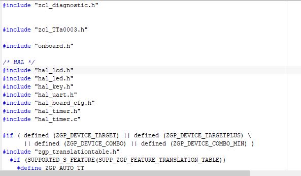

  • You have to include hal_timer.h in your C file.
  • Hi Mr YK,
    Yes, I already inserted, in my c file, as you can see bellow:
  • You also need to add hal_timer.c into your project.

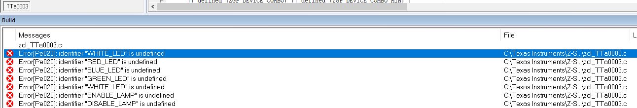

    When I comment out b variables declaring, the compiler running without Error [e46], but present the error [Pe020]
    When I comment out #define ENABLE_LAMP and #define DISABLE_LAMP
    Error[Pe020]: identifier "ENABLE_LAMP" is undefined C:\Texas Instruments\Z-Stack Home 1.2.2a.44539\Projects\zstack\HomeAutomation\TEHA0003\Source\zcl_TTa0003.c 1369

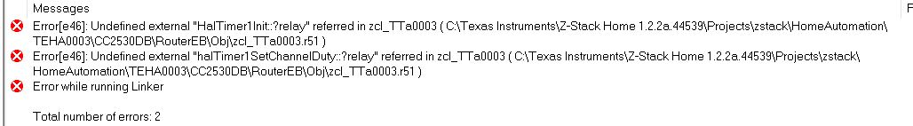

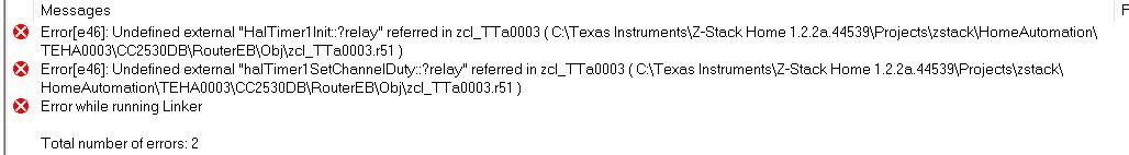

    When all the variables where declared, as I said in (a) and (b) items.
    Error[e46]: Undefined external "HalTimer1Init::?relay" referred in zcl_TTa0003 ( C:\Texas Instruments\Z-Stack Home 1.2.2a.44539\Projects\zstack\HomeAutomation\
    Error[e46]: Undefined external "halTimer1SetChannelDuty::?relay" referred in zcl_TTa0003 ( C:\Texas Instruments\Z-Stack Home 1.2.2a.44539\Projects\zstack\
    HomeAutomation\TEHA0003\CC2530DB\RouterEB\Obj\zcl_TTa0003.r51 )
    Error while running Linker

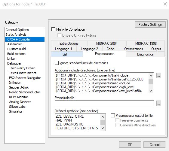

  • Since all those variables (a and b) above already declared in hal_board_cfg.h, I suppose you only need to include hal_board_cfg.h in your c file and don't have to add those defines again in your C file.
  • Hi Mr YK,
    I've done this before, but I always see the Pe020 error. I didn´t see anything else to fix it. Would you can advise me, please?
     As you can see bellow:
    Compiler options and path:
    My C file Includes:
  • Where do you define all those variables (a and b) in hal_board_cfg.h? There are different board defines in hal_board_cfg.h so you have to make sure you put them in right place.

    But during compiler process I got some errors:
    The above errors have a correlation with those code lines in my C file:
    #if (defined HAL_BOARD_ZLIGHT) || (defined HAL_PWM)
    HalTimer1Init( 0 );
    halTimer1SetChannelDuty( WHITE_LED, 0 );
    halTimer1SetChannelDuty( RED_LED, 0 );
    halTimer1SetChannelDuty( BLUE_LED, 0 );
    halTimer1SetChannelDuty( GREEN_LED, 0 );
     I can take out above code lines? Or it will damage my PWM functions?

  • If you don't use those lines, how do you implement PWM functions?
  • Hi Mr YK,
    I had success to compiler out after deleted the part of code lines as I said you before.
    I response to your last question,"how do you implement PWM functions?":
    I didn´t implement it yet in the correctly "CC2530EB/hal_board_cfg.h" file. I tried to do it bellow the macros but I didn´t have a success.
    In the wrong  file that i used (CC2530PMP4712/hal_board_cfg.h) has a part of code that have a PWM lines (at INIT_PWM_PINS), but in a correctly target file is not have),.
