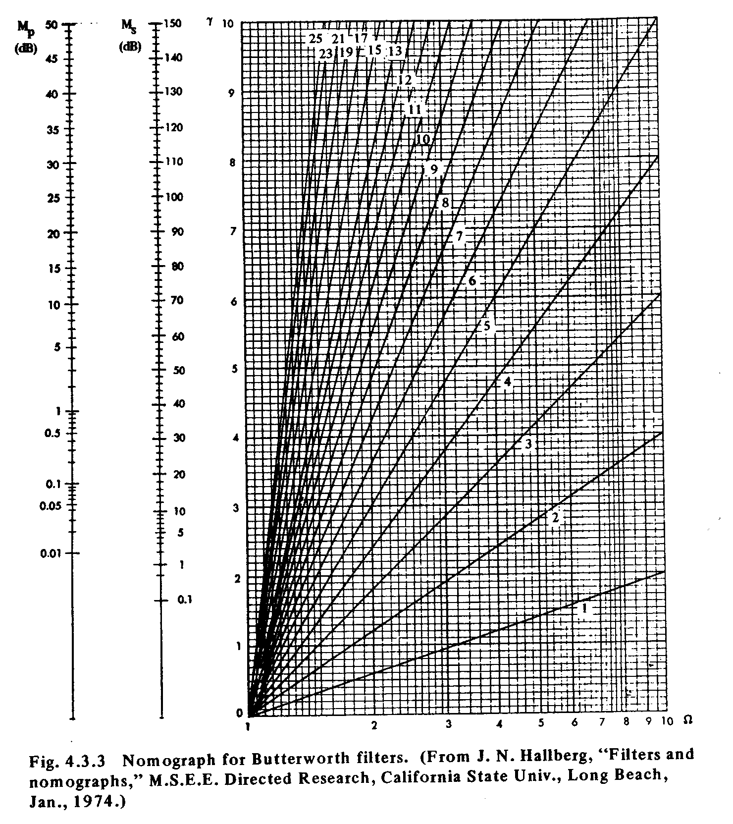

Take a look at figure 1 below to see the different filter bands described above.
Figure 1. Representation of different filter bands

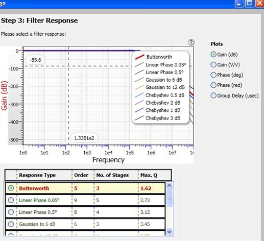

Suppose you want to design a low pass filter, assuming an active filter with -3dB at 300kHz and -60dB at 1.2MHz. Once you’ve decided which filter type you’re going to use, you’ll need to determine the minimum filter order.
Suppose you want to design an anti-aliasing low pass filter where your goal is to minimize ripple. You’ll need to look at the Butterworth nomograph and follow these steps:
  • Determine Ω= ΩSP
  • Extend a line to connect between  MP and MS
  • Draw a horizontal line across graph to intersect Ω
  • The higher number represents the minimum filter order
In this example, you’ll need a fifth order.
If you plug the same numbers into FilterPro, you get the same answer. See the below figure.
