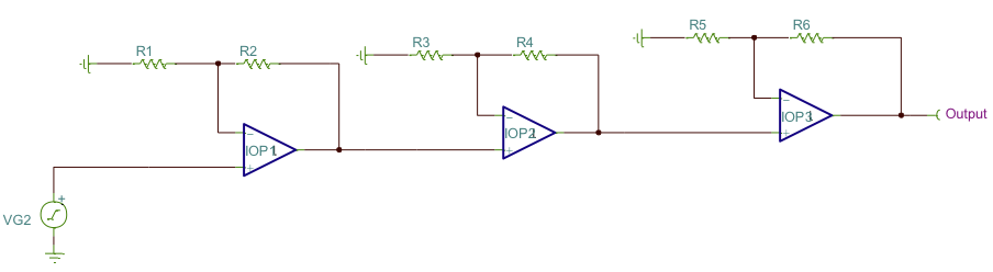

Check out the below diagram to see the overall architecture in a 3-stage amplifier.
The noise contribution of each successive amplifier will add as an RMS sum with the earlier stages weighted by the gain of the later stages.  For a 3-stage architecture, this can be expressed as:
Whereas the gain will simply be multiplied together, as shown below.

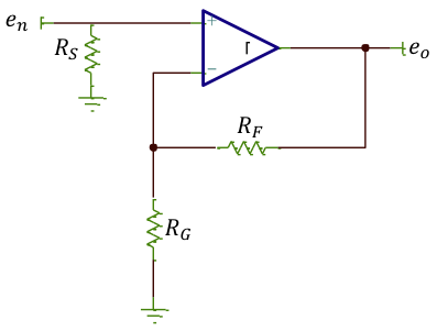

The non-inverting input stage noise, shown below in Figure 1, in a high-gain configuration can be modeled as:
Figure 1: simplified noise model
We now know that we need to pick an amplifier with the lowest possible voltage noise.  Since we  want  to achieve as high a gain as possible in the first stage, while maintaining good bandwidth, we will look at the lowest voltage noise amplifier possible with the highest Gain Bandwidth Product (GBWP).  Take a quick look at the parametric search yields below.

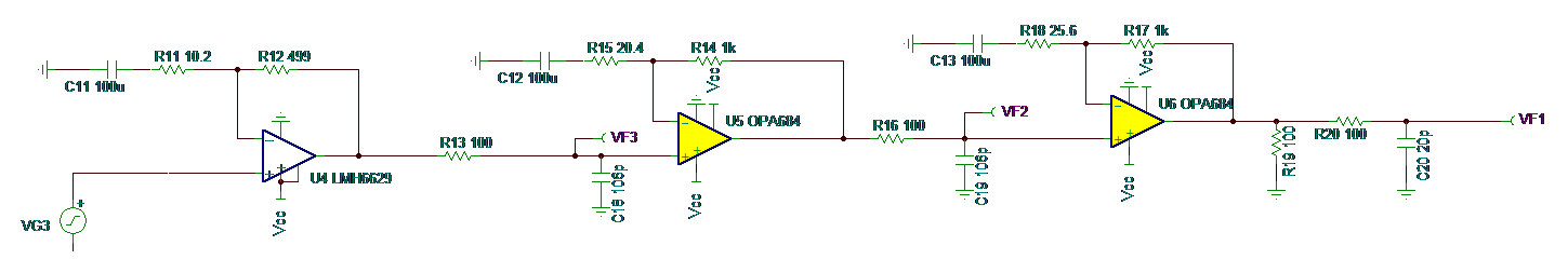

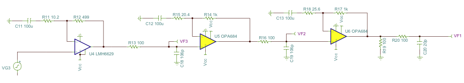

Putting all this together and replacing the ideal amplifiers from figure 1 above yields figure 2 below.
Figure 2: Implementation of a 100,000-V/V multi-stage amplifier with 10MHz bandwidth.
RC filters were inserted between the stages to minimize the noise contribution.  The overall frequency response and -3dB bandwidth can be approximated to 6 first-order pole [1].
