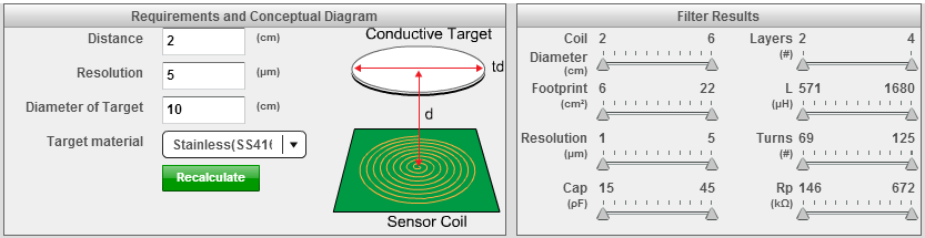

1. Input system requirements.
Suppose you want to design the smallest possible coil on a 4-layer PCB that can measure a 10cm stainless steel target with 5μm resolution at up to 2cm distance between the target and the sensor coil. You can insert these requirements into the ‘Requirements and Conceptual Diagram’ panel. You can even pre-filter the results in the filter panel if you’d like.
Remember that the maximum target distance at a given resolution varies with coil diameter. To learn more about maximum target distance, check out this blog post: Top three LDC1000 questions.
