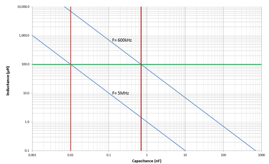

Using the example of the LDC1000, which has a sensor oscillation frequency range of 5 kHz < fsensor <5 MHz, we can draw the following graph:
Figure 1: Graph of constant frequency lines

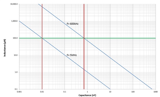

As an example, if we have a sensor coil with an inductance of 100 µH and want an oscillation frequency of 600 kHz, we need to use a 704 pF capacitor. If we wanted an oscillation frequency of 5 MHz, we would need to use a 10.1 pF capacitor (Figure 2.)
Figure 2: 5 MHz and 600 kHz sensors

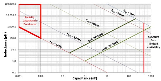

Finally, we need to consider the RP of the sensor. Devices like the LDC1000, LDC1041, and LDC1051 can drive sensors with RP as low as 798 Ω.
The value of RP can be calculated from the Q of the sensor using the equation:
Let us pick two sensors, one with Q=5 and the second with Q=25. When we graph the two sensors across the 5 kHz to 5 MHz range, we can add the two lines that correspond to the LDC1000’s minimum RP of 798 Ω. Notice that the higher Q sensor has a larger range of acceptable capacitor and inductance values (Figure 5.)
Figure 5: RP limitations

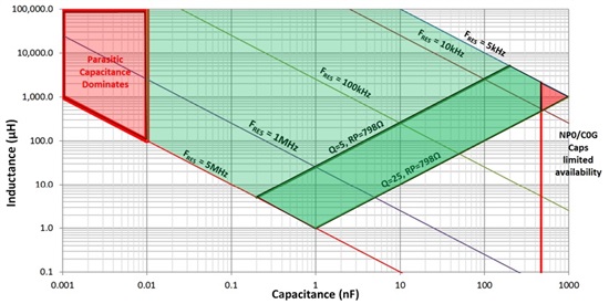

With some color-coding, we get the map below:
Figure 6: Operation region
The light green shaded region is the operational region for a sensor with a Q of 5, while a sensor with a Q of 25 can operate into an extended region, indicated by the dark green shaded region.
Finally, we can see the operational region available. The following constraints need to be followed:
  1. While the sensor capacitor can be as small as 10 pF, 100 pF or larger is recommended for most applications.
  2. Obtaining sensor capacitors larger than 470 nF can be difficult, so there is a limit on the lowest frequency sensors.
  3. While the LDC1000 can operate with sensor inductances as low as 1 µH, a practical minimum sensor inductance is  ~5 µH due to the sensor RP.
  4. A higher Q sensor offers more flexibility in selecting a sensor configuration
