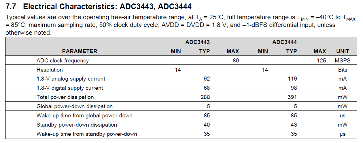

Looking at the data sheet the ADC3444 has two distinct power supplies: a 1.8V analog supply and a 1.8V digital supply. The data sheet provides the following information in the electrical characteristics (Section 7.7) section and in the application section (Section 11).

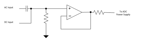

When evaluating the performance of an ADC, the ADC has the advantage of being its own digitizer. We are interested in what will happen to the fast Fourier transform (FFT) while digitizing a single-tone signal and adding a noise tone to the ADC power-supply pins. In order to simplify, we will not worry about the supply noise, but will send a sine wave superimposed on the DC power-supply voltage. We can achieve this superimposition using a power amplifier, as shown in Figure 1.
Figure 1: Power amplifier simplified schematic
Note that the DC gain is set to 1V/V. The small isolation resistor is used at the output to help prevent instability in the amplifier caused by capacitive loading.

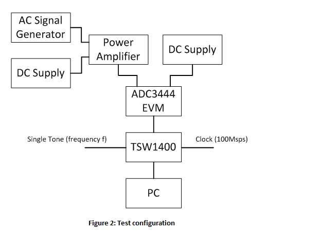

The test configuration, shown in figure 2, does not make any distinction between the analog supply pin (AVDD) and the digital supply pin (DVDD). To isolate possible interactions between the AVDD and DVDD supplies, the measurement procedure introduces a noise tone on a single supply at a time. The decoupling on each supply follows the ADC3444 datasheet recommendation. The thirteen AVDD pins will use each a 0.1µF, X7R capacitor for a total of 1.3µF. Similarly, the four DVDD supply pins will each have a 0.22µF, for a total of 0.88µF on the DVDD supply.
Figure 2: Test configuration

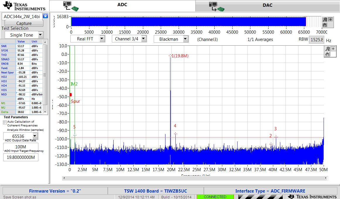

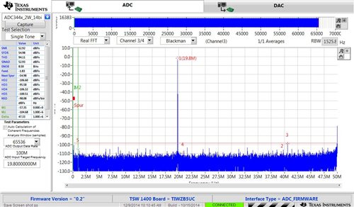

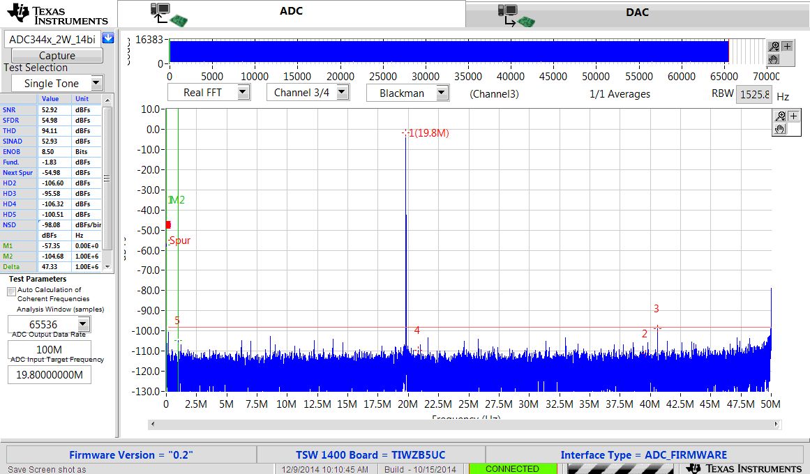

Figure 3 shows the results for ADC3444 power supplies. Each chart below is the Fast Fourier Transform (FFT) of the analog signal. The FFT is the decomposition of the signal as a sum of sinewave. Simply put, the charts show the frequency content of the signal. The x-axis is thus the frequency, with the y-axis representing the magnitude of each sinewave. In the example below, we use a 100MHz clock, resulting in the acquisition bandwidth of 50MHz.
The signal fed to the ADC is a 19.8MHz with a magnitude of -2dBFS (dB Below Full Scale). This is shown in figure 3, which is the reference signal with no noise tone.
Figure 3: ADC3444 AVDD reference FFT
To evaluate the PSR of the ADC, the following procedure is devised for each supply:
1- Connect the amplifier to the power supply being evaluated [Here this will be either the AVDD or the DVDD]
2- Connect the DC-power supply to the other power supplies. [This DC power supply is a clean power supply and has been selected for its low noise characteristics]
3- Turn on the noise tone and capture the FFT. [The noise tone has been selected to maximize the disturbance on the supply pins under test, while still respecting the supply tolerance.]

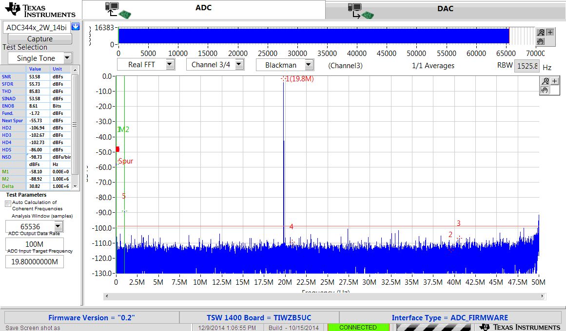

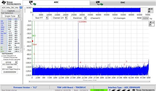

Figure 4 shows the same signal tone into the ADC, but this time adding a noise tone in the AVDD power supply pin. Since all other conditions are equal, any degradation on the FTT can be correlated to the addition of the noise tone on the AVDD supply.
Figure 4: ADC3444 AVDD response to 100mVpp 1MHz sinewave superimposed to the 1.8V

Notice that for the AVDD supply (Figure 4), three additional spurs have appeared: at 1MHz, 18.8MHz and 20.8MHz. The first tone is to be expected, as the noise tone gets added to the acquired spectrum. The two other undesired tones are exactly 1MHz to the right and to the left, symmetrical to the center frequency.
For the DVDD supply, the only difference between Figure 3 and Figure 5 is a new spur at 1MHz.

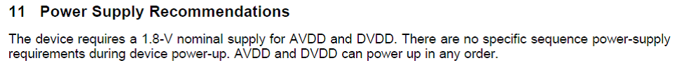

Let’s use Figures 6 and 7 to help us interpret the result and translate the dB below full scale (dBFS) to a PSRR specification. Say that the fundamental amplitude is -2dBFS. Since the ADC3444 data sheet, in figure 7, tells us that 0dBFS (or full scale) is 2Vpp, we can convert the dBFS into Vpp. This is possible with Equation 1 below:
