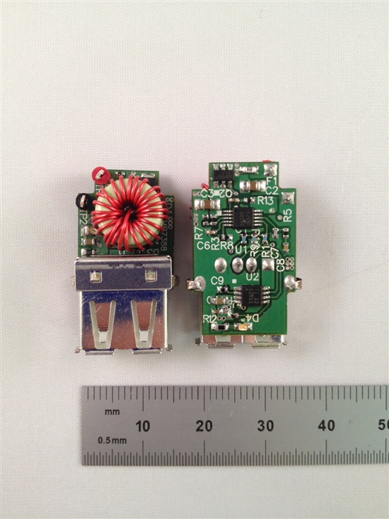

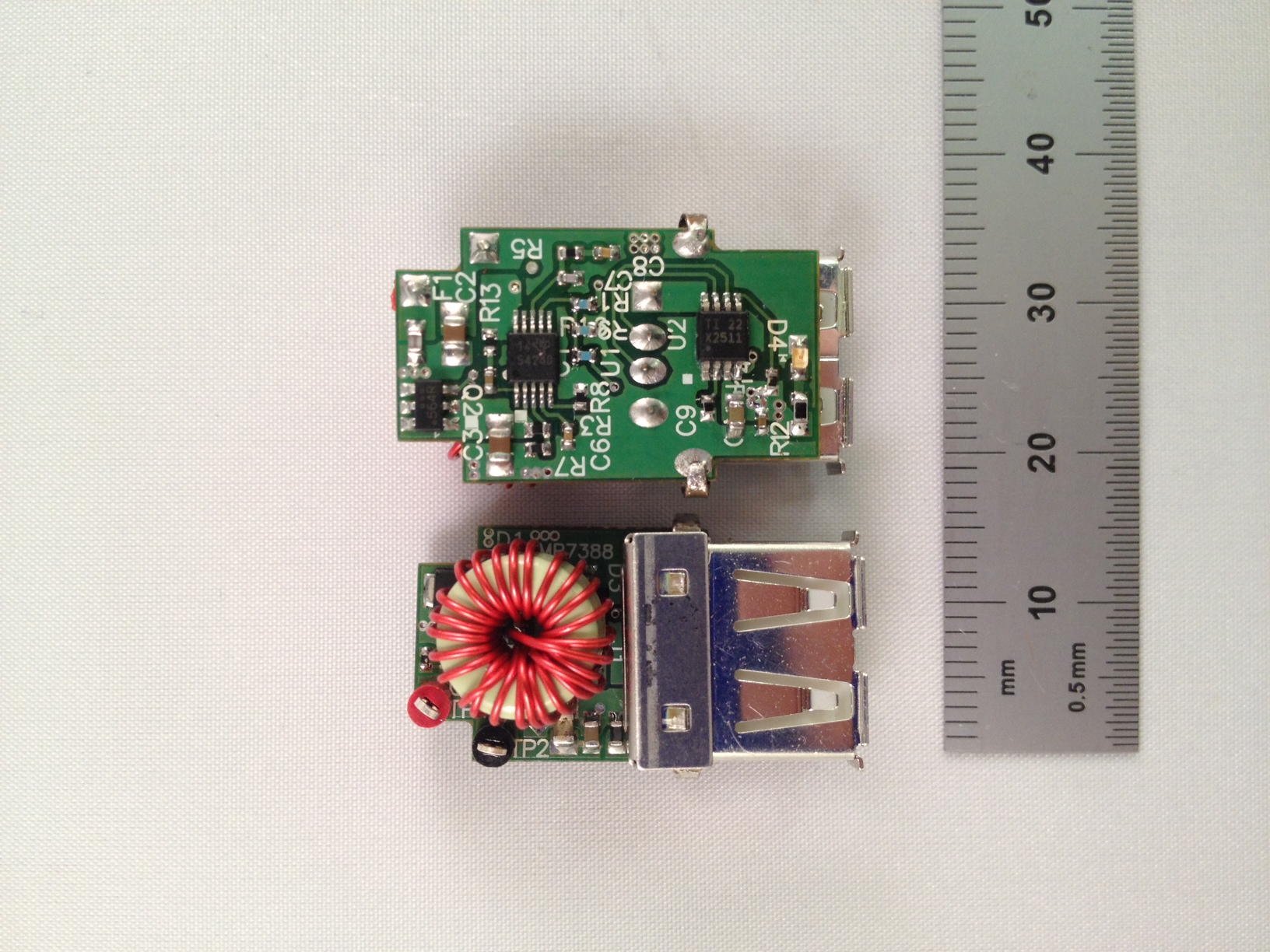

With the above in mind, I created two USB DC/DC charger designs you can use for free: PMP7388 and PMP7390.
For a single port charger in a form factor that fits flush with the surface of a cigarette lighter plug, use the PMP7388.
Uses the TPS54240 and TPS2511 for a non-synchronous buck converter with integrated high side FET.  The TPS54240 can handle input voltages up to 40V, to protect against high surges on the input a conditioning circuit used to clamp the input voltage to 39V.  The output is capable of providing 2.1A and offers “universal charging” via the TPS2511.

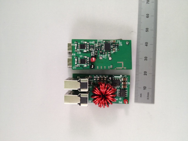

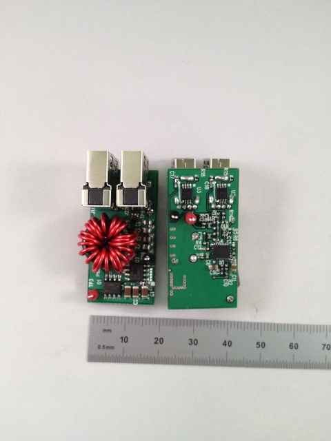

For a dual port charger, use the PMP7390.
The PMP7390 dual port charger using the TPS40170 synchronous buck converter designed with external FETs to give high efficiency and low thermal dissipation.
Uses the TPS40170 synchronous buck converter designed with external FETs to give high efficiency and low thermal dissipation.  The output is capable of providing 5V at 5A and offers “universal charging” via the TPS2511 for each port.
