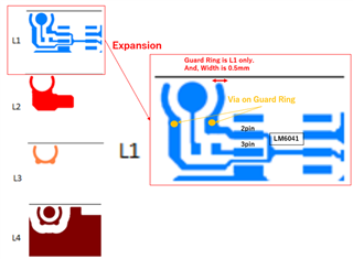

    [Q5]
    Our customer use SOIC PKG and 4 layer board.
    And, layout of Guard Ring is layer 1(L1) only.
    Should Guard Ring be placed on all layers?
    [Q6]
    They have a via on top of Guard Ring.
    Could you please let us know if you have any concern?
    <Their Layout image>
    Hide
  • Hi Hide,
    it's still not optimal. An unwanted leakage current can flow trough the FR4 material:
    Kai

    Could you please let us know if you have any comment for via?
    And, I understand that An unwanted leakage current.
    Could you please let us know improvement if you have any idea?
    Hide
  • Hi Hide,
    Kai is correct regarding leakage through the FR4 material.
    Improvements can be made, but they all depend on the application and required performance.
    when possible, I typically remove the soldermask from the guarded area as this is another source of leakage from the signal to the PCB.
    Creating a via fence can offer additional guarding for the sensitive input, See example:
    This via fence is not a perfect solution, but should slightly reduce leakage through the substrate.
    Alternatively, you can have a slot cut into the board outside the guard ring to physically separate the guarded area from the non-guarded area.
    This will reduce leakage, but typically increases complexity and cost to manufacture:
    Finally, picking a different PCB material can be an effective and simple way to reduce leakage through the substrate. PTFE or ceramic substrates will offer lower leakage than FR4, though cost more to produce. We have used Rogers 4000 series in the past for ultra low leakage PCBs.
    Hopefully this helps a bit in creating your guard structure.
    Jacob
