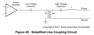

We are looking for a power amplifier  chip that delivers 1A-2A output current with protections. The input signal is a logic AND of an 88KHz PWM and a series of RS232 data, both from an MCU. The load of the power amplifier is a transformer.

    The signal to be fed into OPA521 is a combination of a PWM and a signal from UART, both generated by an MCU. The PWM is 50% duty ratio with frequency of 88KHz, and the signal from UART is a series of byte data in RS232 protocol (1 start bit, 8 data bits, 1 stop bit) in 9600 baud rate. The input signal to OPA521 is the logic AND of the PWM and the negated UART output, i.e.  PWM  AND (~UART_OUT), this is the same as the E_Tx_OUT signal in AFE030. The ampltitudes of all three signals are 0 - 5V. The OPA521 drives a transformer with (primary : secondary) ratio of  (1.3 : 1) as shown in the figure below (copied from AFE030 datasheet, Page 48), assume the frequency range of the transformer is 50KHz - 2MHz:

    In the AFE031/AFE030 EVM and user guide, the FSK communication protocol is sinusoidal in nature and it is purely analog from input to output. So is the specific transformer in AFE031 EVM is designed for the FSK communication protocol.
    https://www.ti.com/lit/ug/sbou223/sbou223.pdf?ts=1695225792479&ref_url=https%253A%252F%252Fwww.google.com%252F
    There are transformer that is designed for squarewave PWM signals, but these transformer tend to be very low input capacitance and specially designed for a driving application. such as mosfet gate driving transformer. I am not certain about ~2MHz range, but 100s kHz range are very common (if the input capacitance is high, then the output may look like sinusoidal at the secondary side of the transformer).
    So I was not clear if the communication protocol is driven is square wave or sinusoidal waveform. OPA521 is capable to drive the transformer load as it is shown in PLC application.
    Enclosed is the datasheet of the transformer specified for AFE031 EVM. I recalled that the magnetic may be able to handle up to 500kHz range. The magnetic core may become very lossy beyond 600kHz range or so. .
