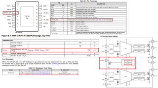

Please help me with these questions related to thermal and temperature of ALM2402-Q1.
  1. at section 7.3.5, how to understand the safe limits and thermal shutdown hysteresis? Is there a specific number of these values?
    1. In my understanding, the safe limit is TJmax 150℃, from the TJmax to OTF is the hysteresis, is that right?
    2. How long can the device works in this region?
  2. How to understand "The op amp toggles on and off between the thermal shutdown hysteresis", do you know how to shutdown these devices safely when thermal shutdown occurs. In the other word, I want to turn off this device with a specific signal.
    The absolute maximum die temperature is 150 degrees C. However please note the footnote in the datasheet below.
    The typical hysteresis is approximately 7-10 degrees.
    First of all, ALM2402F-Q1  or ALM2403-Q1 is the resolver driver. ALM2402-Q1 has certain limitation for resolver application, since its full power BW is not high due to the low slew rate.
    In ALM2402F-Q1, the OTF/SH_DN pin has dual functionality. If the internal thermal shutdown is occurred due to elevated Tj temperature, the OTF pin's voltage will pull low (< 0.4V) from the internal overtemperature circuitry. At the same time, SH_DN pin can pull low to shutdown the output (from low impedance to high impedance) with an external circuitry, such as the pin is driven by GPIO from MCU/DSP processor. The OTF/SH_DN pin is how you would shutdown the driver safely, if some desired or undesired events are commanded or detected.
    Typically, resolver's overcurrent or short output current conditions can result the ALM2402F-Q1/ALM2403-Q1 into overheating or high heat dissipation conditions, where the internal Tj is rising and cause the IC's internal thermal detection circuitry to be activated - this is the IC's default self thermal protection feature. If the design requirements have current sensing circuitry and would like to use the status to activate OTF/SH_DN pin, you may certainly do that. Since I do not know your customer's specific fault conditions to be protected, I am unable to provide the details recommendation for the application.

  • Hey Josh,
    The thermal shutdown temperature is listed in the product datasheet with a typical of 165 degrees F. The hysteresis is typically 7-10 degrees based on measured data.
