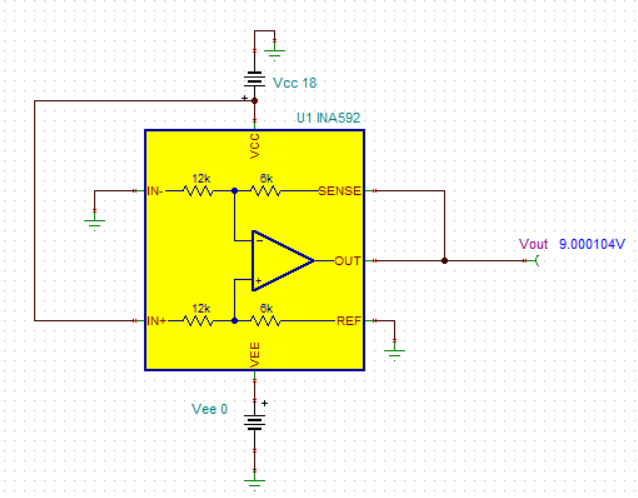

In my opinion, figure 79 contains an error.
The voltage at the output is:
(V+) x 0,33
because of 12k and 6k resistor divider.
