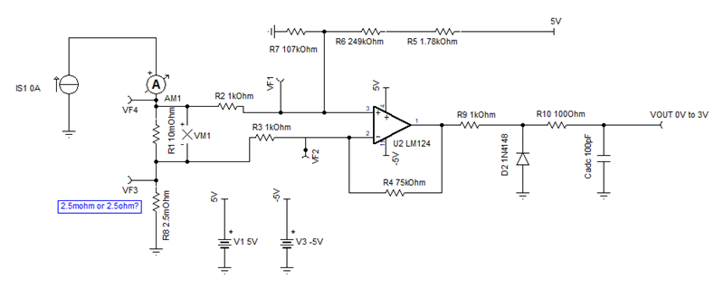

I am using the LM124AQML-SP for signal condition before going into another buffer op amp that will drive a 12 bit SAR adc. My positive rail will come one before my negative rail and I found the below E2E post on power sequencing for op amps. Will the TVS diodes and silicon rectifier diode configuration described in the post mitigate any errors of my power sequencing?
If I don't add these diodes, will my output go high until the negative rail is powered up?

  • Hello Kai and Ronald,
    Will the op amp still be damaged if there is no signal on the input pins before both rails turn on even if they turn on at different times?
    If there is a positive signal or negative signal on the input pins before the positive and negative rail is powered on will that damage the op amp?
    Also will I have to add diodes on my input as well? From the design guidelines, it appears that they already have them internally? "All the input pins have a diode from the input to the device’s GND, or V–, pin. In dual supply applications, the GND pin will be negative." - page 27
    The positive voltage rail will be powered from a 5V rail getting stepped up to 10V by a charge pump (driven by MSP which is powered by the same 5V rail but has an LDO to step down to 3.3V) and then a shunt reference voltage will create a clean 5V rail . The negative voltage for the op amp supply will be produced by a inverting charge pump (driven by MSP). I don't currently have any waveforms, but I can work on getting those if they are necessary.
    With my power setup, do I still need to clamping?

  • Jack,
    I looked at the circuit. I'm hoping that R8 is supposed to be 2.5 milliohms instead of 2.5 ohms. Otherwise the input common mode range will be violated. Also the huge common mode swing will dominate over the desired sense resistor voltage for huge measurement errors with real 1% resistors..
    With a 5V supply, it best to limit required VOH to 3V. So I reduced gain to 75 and shifted offset to 1.5V, now +/-2A creates a 0V to 3V output for loads that are terminated to ground. I also reduce the op amp count to 1. Note the op amp input offset error of +/-2mV creates an output offset of +/-152mV (noise gain is 76)
