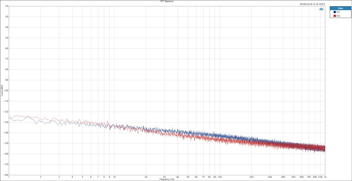

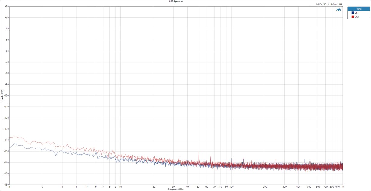

    Here are two plots from my APx555 - showing the noise from my prototype, this is including all contributions, from DAC to output stage. The first plot is a bad LME49720, the second a cheap-as-chips NJM2114. The situation is actually worse than it looks here, because this noise is impulsive, much like popping corn, and the FFT is integrating it.
    I have other samples which are similar, or worse.

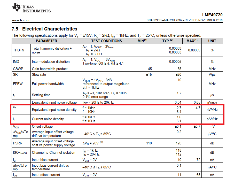

    what do you expect from a chip which has no maximum specification of 10Hz noise?
    This is not a mistake of the LME49720 but is typical for almost all such OPAmps. By the way, your NJM2114 does not have any maximum specifications referring to noise! So, don't expect too much from the NJM2114. It might show the same increased noise some day.
    And even the NE5532/4 is showing huge manufacturing tolerances referring to noise, regardless of the manufacturer. I remember, many years ago we had to screen all of our NE5534 for the use in a professional audio application. There were three groups, one group containing the lowest noise devices for the use in high gain microphone amplifier stages, another group with noisier devices for high gain but less demanding amplifier stages and a third group for low gain amplifier stages. 5% of all screened NE5534 fell in the lowest noise group, 50...70% fell in the second group and about 30% fell in the third group. 10...30% of the devices, depending on the batch, couldn't be used at all and would be better placed in the dustbin.
    So, if you want to get state-of-the-art low noise devices, then you should screen them.

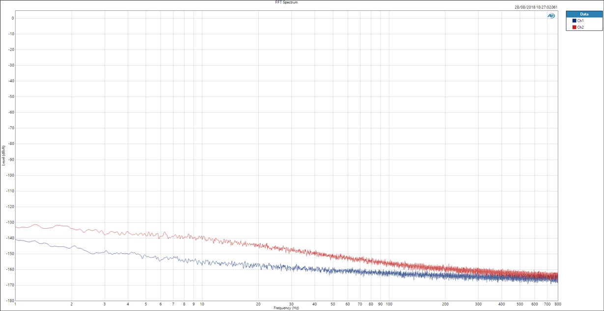

    I received 4 more pieces from our partner today and all four of them have this popcorn issue - so we are looking at approximately 50% of samples overall so far. Below is a typical noisy LME49720, below that is a LM4562 obtained locally:
