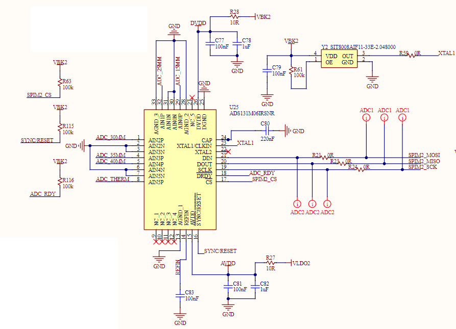

Hi, I've been running into an issue with the ADS131M06 where if I try to decrease Oversampling Rate to anything below 4096, I get data from the previous sample bleeding into the next sample for each channel. This has effectively limited the overall sampling rate and can only be improved by increasing fCLKIN. I have tried with clock-rates of 2MHz and 4MHz but the same 4096 OSR limit has remained, and would assume it to stay if we went up to 8MHz.
Hardware wise, we believe we have stuck to the layout example in the datasheet, and have probed the input to each channel without observing any such bleed in the input signal.
For our application each sample is from a completely different source, and there cant be any bleed from previous samples. Is this expected behavior? is there a setting I'm missing to prevent this from happening, or a hardware configuration change?

    This sounds like an interesting application, would you mind providing the ADS131M06 portion of your schematic?
    Does this mean that you are mulitplexing different input sources to the ADC channels after each conversion result? This would not be the intended use of this device due to the integrated sinc filter latency. Delta-sigma ADCs require some history to convert the analog input signal, unlike a SAR ADC.

    We aren't directly multiplexing the input sources, each channel is always looking at the same sensor. However, after each sample we do shine a different wavelength LED to be picked up by the sensors. It sounds like that 'history' requirement inherent to Delta-Sigma ADCs could be the issue causing effective bleed through at lower OSRs.
    Here is the schematic just in case that is still of use.

    Thanks for clarifying the application and for providing part of the schematic. I did a quick review and the connections look correct to me.
    Changing the wavelength of light applied to your optical sensor is likely producing a step-change to the voltage seen at the ADC input pins (you might be able to verify this with a scope, though I'm not sure to what scale you're seeing the effects at the output). Any transient voltage will take some time to settle in the analog domain as well as additional time required to propagate through the digital filter (3 data rate periods for the sinc3 filter output).
    My only guess as to why you don't see this at OSR = 4096 or greater is that the internal averaging is so high that the input transient is not enough to significantly disturb the digital output.
    Note that the output data rate scales directly with OSR. So ideally, one would choose the highest CLKIN and OSR combination possible to achieve a specific data rate with the best noise performance. Is there a reason you need to reduce the CLKIN frequency from the default 8.192 MHz?

    Also I have checked the voltage input to the ADC channels and they do change dramatically as the LED source switches, that is expected for our application, so it sounds like we are just not using the correct type of ADC for the job. The internal averaging is likely something that we will just have to work around as long as we're working with this ADC, but luckily the 8MHz 4096 OSR configuration should get us to where we want to be.
