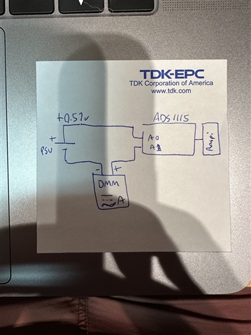

To try to get a better understanding, I drove the differential input with a floating bench supply at 0.51V per the following diagram:

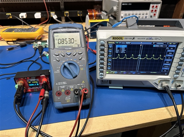

Note that the DMM is set to RMS AC+DC current mode, since the current waveform pulses. I had also tried using a current shunt amplifier (LowPowerLabs Current Ranger) and my oscilloscope, which produced the very pulse-y waveform at the bottom of this post. I noticed at that point that my DMM measurement disagreed with the RMS measurement on the scope, at which point I switched to the proper DC+AC mode on the meter and then became confident in that measurement.
Measuring this way, I saw that the bench PSU was sourcing 6uA DC+AC into the ADC, which at 0.51V works out to 85kOhm (!!!)
To check the operating mode, I manually changed the sample rate up from 8sps, and manually changed the full scale range down (gain up) both of which resulted in yet higher current drawn from the PSU. I confirmed that of all combinations, 6.144V FSR and 8sps resulted in the lowest current measurement I could achieve.

Here's that waveform I mentioned. Ignore the DMM and RMS scope measurements, these were taken at a different input voltage from the 0.51V above.
