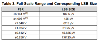

    • FSR: checked with 2.048V and 4.096V and the formula used to convert the ADC value is voltage = ((adc_value * FSR * 1000) / 32768);
    The voltage value is calculated by multiplying the output code, when converted from binary to decimal, times the LSB size corresponding to the FSR configuration.
    Voltage value = adc_value (in decimal) * LSB size
