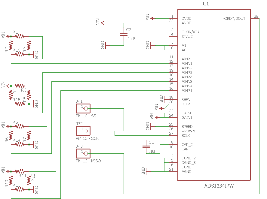

I am a mechanical engineer being pressed into service as an electrical/computer/software engineer, so I am still learning a tremendous amount. Anyways, I am trying to create a system that uses four load cells. My goal is to connect these to a Raspberry Pi 3 and I am trying to use a 24bit 4 channel ADC to do it. I didn't know which ones to use so I ordered an ADS1234, 4 ADS1231's, and an MCP3304.
I have hooked up the ADS1234 with all four load cells and connected it to the SPI interface on an Arduino Uno (for testing). I am having some trouble getting it to work and I was hoping you  all could help. I followed Figure 42 in the ADS1234 datasheet, but to no avail. Also, this is the first time I am using SPI, so I really have no idea what I am doing.
I have attached the code that I am using in arudino as well as a schematic of how I have hooked them up. If you all could help me out I would greatly appreciate it!
Thanks!
PS: My VIN is 5V. Forgot to put that into the image.

  • Hi Ross,
    Welcome to the forum!  My Dad always wanted me to be a mechanical engineer because he said 'they can do it all' and I guess you are proving him correct.  I broke his heart by becoming an electrical engineer.  I'm not sure if you actually built a PCB from your schematic or if you are using your schematic in a prototyping system.  Just a comment about your schematic is I don't see wire junctions at some of the intersections.  You want to make sure that all your wires connect as expected.
    One area of concern is the CLKIN pin.  The device requires a clock, and you can either provide one externally (from an oscillator or crystal) or use the internal clock by setting the CLKIN pin to GND.  I would suggest grounding this pin as currently it is floating.
    I also see that you have connected the SS from the Arduino to the PDWN pin.  You need to make sure this connection is not functioning as a SS pin for the SPI, but rather as a GPIO.  PDWN needs to be set high for the ADS1234 to function otherwise it is in a powered down state.
    Regarding your code the SPI should be CPOL = 0 and CPHA = 1 as the data will change on the rising edge of SCLK and holds valid to read on the falling edge.
    Also, conversion is complete and ready to ready on the DOUT/DRDY pin when this pin signals completion by making a transition from high to low.

  • Thanks for the response, but I am still not getting any results.. I added SPI.setDataMode(SPI_MODE1);, and I grounded the clock pin like you suggested.  I am now only get 255 255 255 repeatedly on the serial monitor, though. Also, I have all the pins connected to ground or VIN individually. I didn't use any wire junctions.

  • Hi Ross,
    It sounds like you are using a prototyping system for your evaluation.  I would first verify all my connections.  Second, use an oscilloscope or logic analyzer to verify that DOUT/DRDY is toggling.  If it is not, then you need to find out why, such as PDWN is low and not high.
    If the device appears to be working correctly, then send me scope/logic analyzer shots of the communication.
    Bob B
  • Hey Bob,
    Yes I am using a breadboard and an arduino uno right now for my evaluation. Good news is I have managed to get the ADC to output readings!  I don't really know what I did, but I got it working. I changed the speed to 80SPS, the voltage to 3.3V and Gain to 128. Also, I hooked up the A0 and A1 to PWM pins on the arduino.
    Although now I have encountered some new problems with the measurements. I have hooked up a load cell to AINP1 & AIN1, but the readings hover around 15 million with no weight and go up to 16.7 million or they hover around 16 million with no load, and go to 0-400,000 with load. I have tried changing the SPIModes and the MSB to LSB, but it is only changing the baseline value.
    Secondly, I can only get one sensor to work with only channel 1. That sensor displays readings on the other channels, and sensors plugged into the other channels don't have any readings.
    If you could help me out with these new problems I would greatly appreciate it.
    All the best,
    Ross

  • Hi Ross,
    I'm not sure what the channel error is you are seeing, but the data error is due to improper sign extension.  You are reading a signed 24-bit value into an unsigned integer.  The output of the ADS1234 is binary two's complement.  What you are perceiving as a large value is actually a small negative value.
    So you need to store your data as a signed value, and properly sign-extend the 24-bit value to 32-bit.
    Bob B
