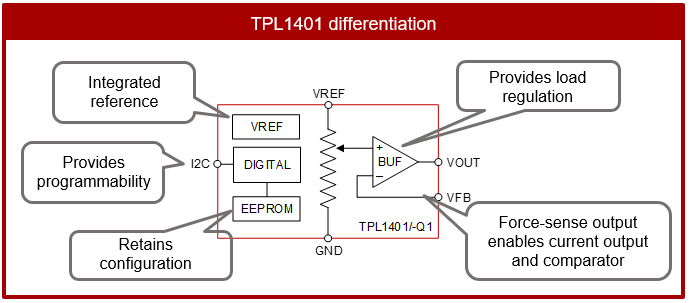

  • TI offers many great low-cost solutions for creating a simple DC bias in our DACs and DPOT portfolio, but when it comes to our lowest-cost device then we have one clear solution. The TPL1401 is a digital potentiometer (digipot) with a buffered wiper. Unlike standard digipots, this device offers higher load regulation in voltage-divider applications as a result of the integrated buffered wiper.
    The TPL1401 is tiny, feature-rich, and easy-to-use building block device that can be integrated into many applications.

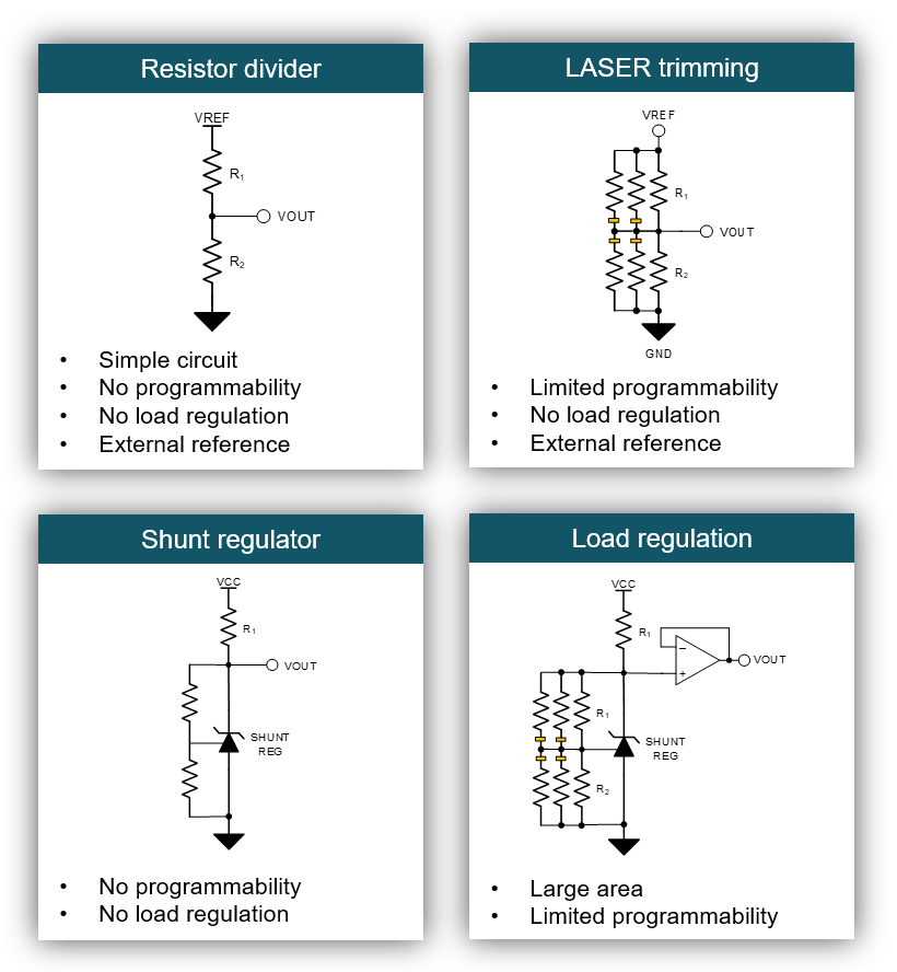

    This device can easily replace common circuits found in many applications, such as resistor dividers, LASER trimmed voltage dividers, shunt regulators, and load regulators.
    The TPL1401 can be considered similar to our 8-bit precision DAC, the DAC43401, but we are able to achieve a lower cost by removing some features that are not needed in simple, DC-bias/setpoint applications.
    The TPL1401 is differentiated from other digipots with the addition of an EEPROM memory, which allows the default configuration to be programmed in the device.  This enables calibration and factory programming to enhance applications beyond simple bill-of-material variants can allow.  In addition, the integrated buffer allows for better load regulation than a standard digipot.  Most importantly, this device also features an internal reference voltage.  This reference allows for a greater level of precision and temperature drift.

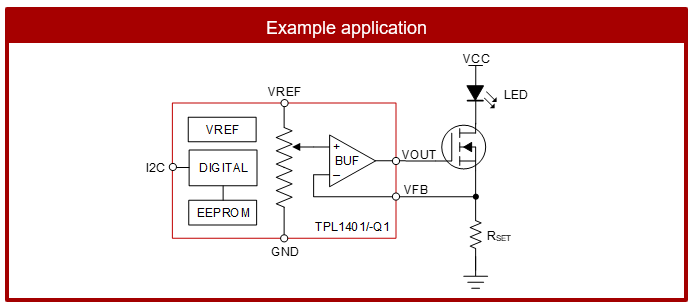

    The external feedback pin allow allows for the device to be configured into a current source or sink.
