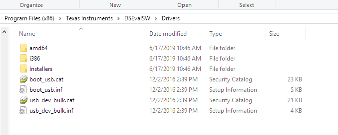

  • Hi Milan,

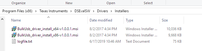

    Welcome to the E2E forum!  The software installation requires administrator rights.  As a part of the installation the drivers will be placed into the windows driver store.  Copies are also made in Program Files (x86)\DSEvalSW\Drivers.  Under the Drivers folder are copies of the drivers and another folder called Installers which has the .msi installers if the drivers need to be reinstalled for some reason.

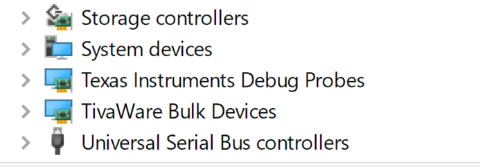

    As there are two programs that need to be installed, you should install the DSEvaluaTIon application first, followed by the ADS124S08EVM-DVCPKG.  Again, this installation requires administrator rights.  If the driver was installed properly you should see in Device Manager a Tivaware Bulk Device.
    Can you verify that the EVM is showing as TivaWare Bulk Devices or is it showing as unknown device when plugged in?
    Can you also verify which folders are missing from the drivers folder?

  • Hi Bob B
    1)      EVM does not show in as TivaWare Bulk Devices. It shows as Unknown Device. Repeatedly. It will “ding when plugged and unplugged.

  • Hi Milan,
    Keep in mind I cannot see what you see.  I showed some screen shots in my previous post.  I understand you are saying you are missing the dll's in the i386 folder, but what about the rest of the folder contents as I showed above?  In particular you should see the msi installer packages in the installer folder in the directory path as shown in the screen shot.  Can you also attach the logfile.txt in your next post if this exists in that folder?
    I ran the installer myself (as did a colleague) to make sure the download takes place as expected.  And yes, you should see contents in the i386 folder similar to the amd64 folder.
