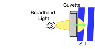

- Transmission sampling consists of directing light through a cuvette or through a NIR transparent material into the slit input of a dispersive spectrometer.
- Transmission sampling is typically used for NIR transparent materials such as liquids, films, oils, fuels, solvent, polymers, plastics, and solutions.
- The main advantage of transmissive systems is that the light is directed through the sample and captured into the input slit of the spectrometer. This provides the most efficient use of light.

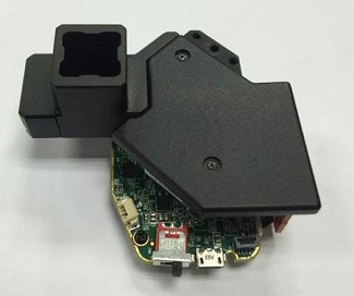

- Example of transmissive sampling NIRscan Nano from Optecks:

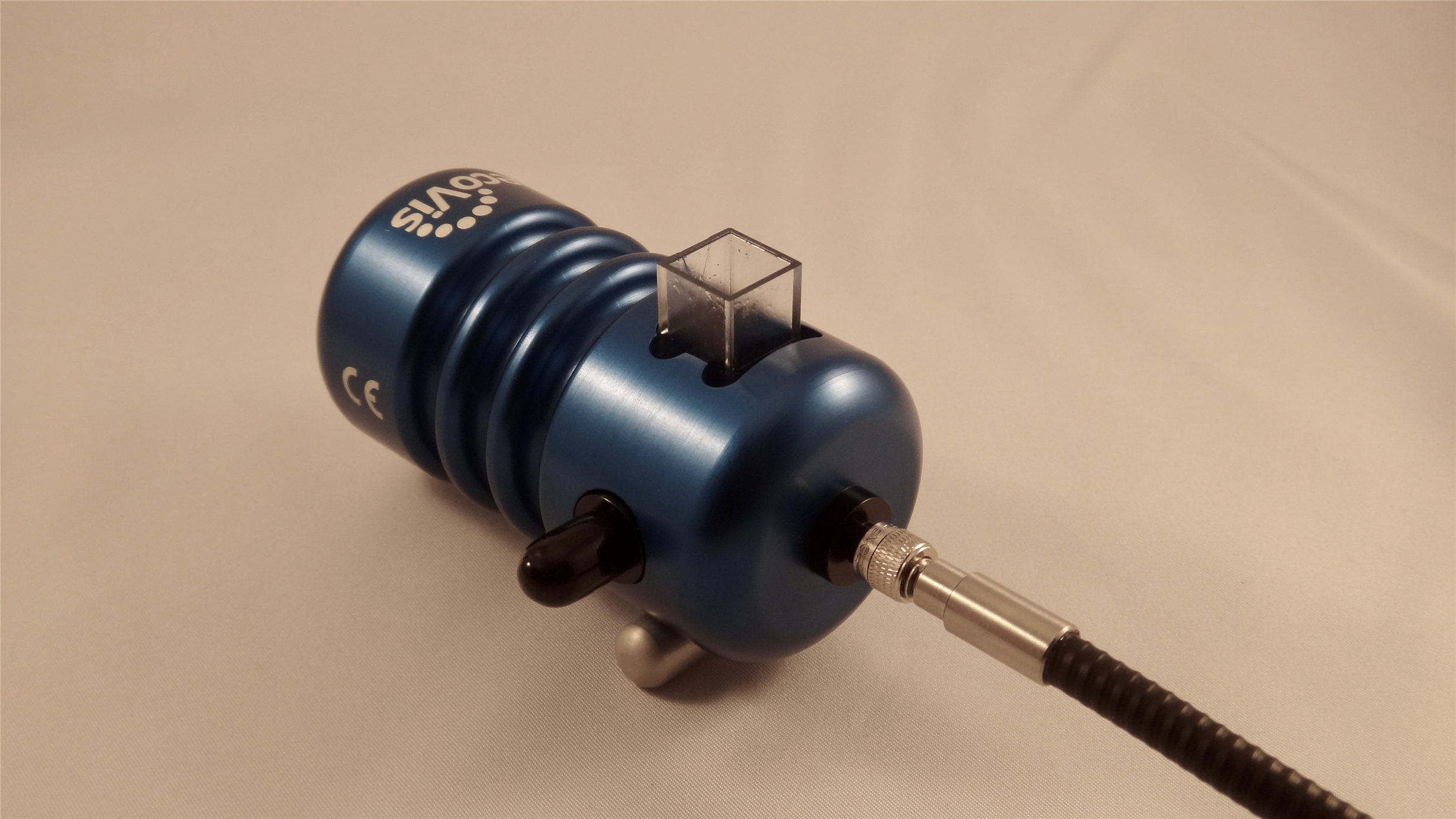

- Example of a transmission sampling with a light source with fiber output:

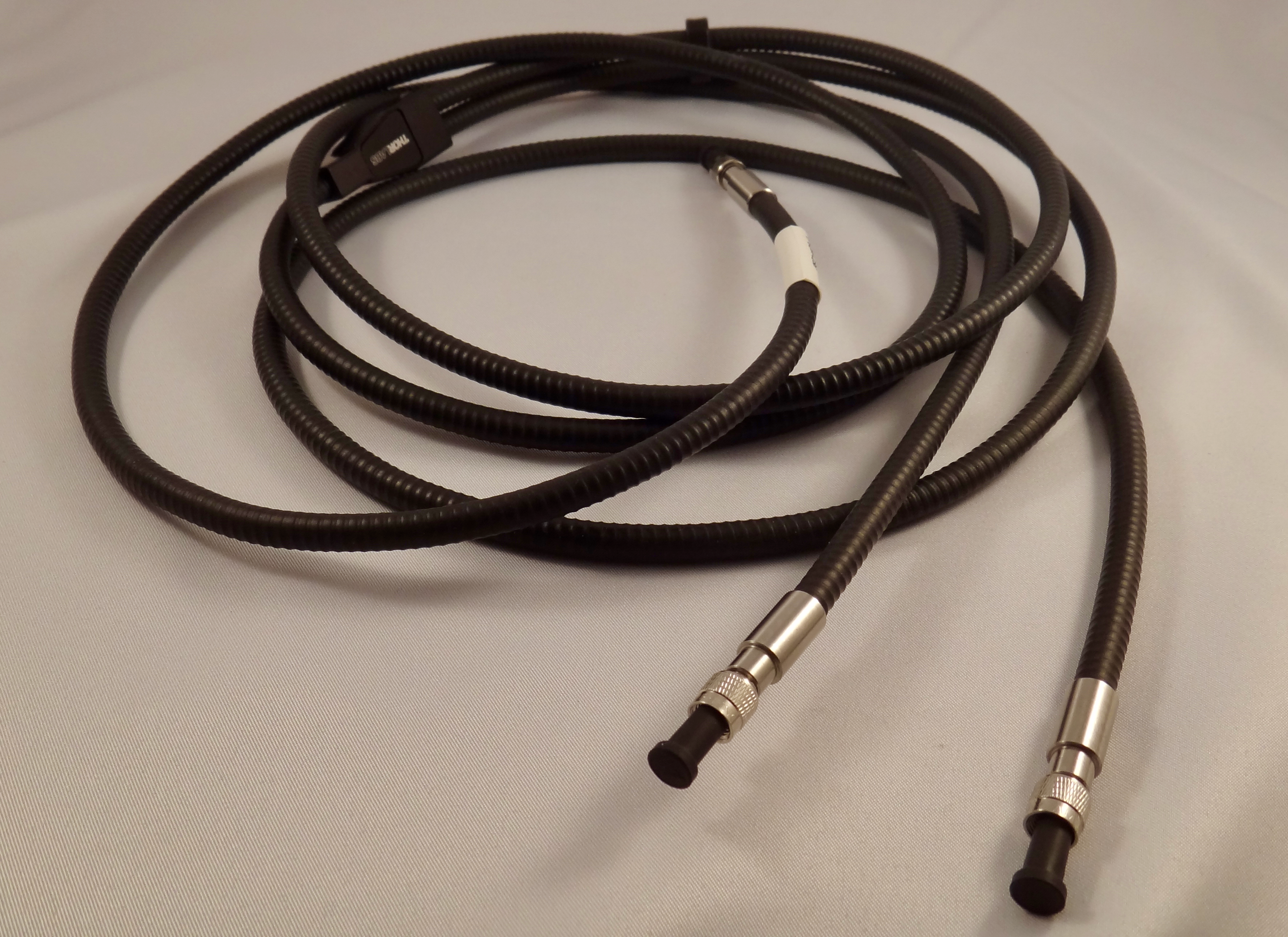

- Fiber optic cable bundles are used in remote sampling. The fiber bundle is typically bifurcated with a set of fiber bundles routed to a light source, while the rest of the fiber bundles capture the reflected light and direct it to the input slit.
- DLP Technology-based spectrometers have tall slits, thus, when combined with round-to-linear fiber bundles that fill the complete slit, the highest performance is obtained:

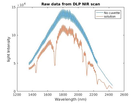

- Why do my scans have large dips in an otherwise good curve?
It is possible that when you are scanning you'll get a result like the image shown below. These large dips are caused by the patterns that are used for measuring adjacent wavelengths alternating between two different widths or number of DMD columns used to take the measurement.
For example, low values might be captured when the pattern is 7 DMD pixels wide, while the higher values might be captured when the pattern is 8 DMD pixels wide. The intensity measured at the detector is proportional to the number of DMD mirrors that are set in the position to reflect incident illumination toward the detector, so as the number of pixels changes in a back and forth manner, the measured intensity will also vary.
More explanation of this effect is available in section 4.2 and figure 9 of the DLP® Spectrometer Design Considerations application note. Specifically, it states:
It is common that the number of columns between the minimum and maximum wavelength to scan is not evenly divisible by the number of wavelength groups desired. In this case, there are a few ways to proceed:
- Keep the column width constant, and step the on pixel group by an amount different than the column width.
- Change the column width throughout the scan, in order to distribute extra columns
- Enforce a constant column width and step size, allowing only certain numbers of patterns in scans of certain wavelength regions.
The DLP NIRscan™ evaluation module uses the second method above. The DLP NIRscan™ Nano uses the first method above. Therefore, the intensity graph of scans performed with the DLP NIRscan™ Nano will not have this behavior.

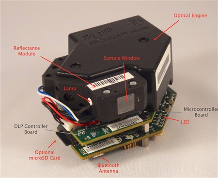

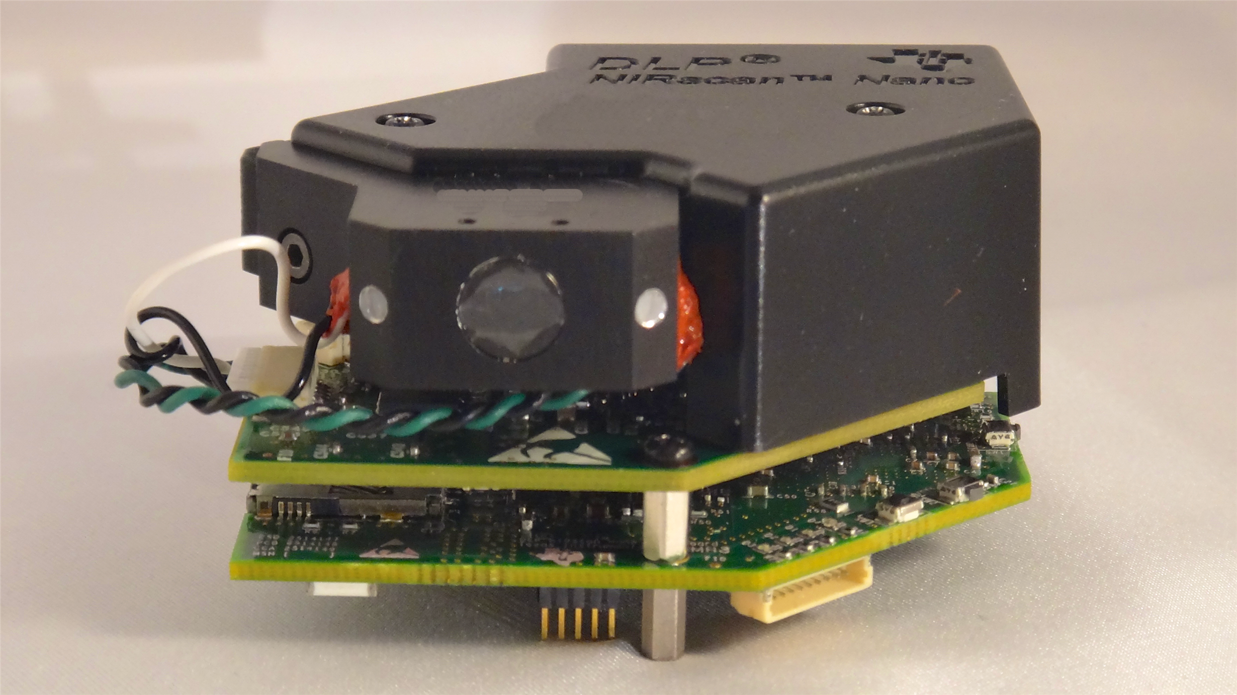

In this picture, you can see the major components of the DLP NIRscan Nano EVM:
Removing the cover to the optical engine reveals the DMD and Detector board:

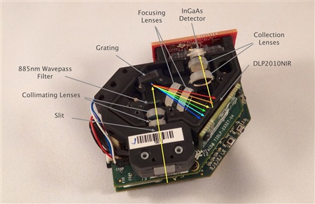

Now if we removed the Reflectance module, you can see the slit:
Now that we’ve gotten inside, let’s take a look at how the light is manipulated.
The light reflected from the sample is gathered by the Collection lens and focused into the optical engine through the input slit. The slit size is chosen to balance wavelength resolution with signal-to-noise ratio (SNR) of the spectrometer. This spectrometer uses a 25 μm wide by 1.69 mm tall slit. The light that passes through the slit is collimated by the first set of lenses, passes through an 885-nm long wavepass filter, and then strikes a reflective grating. This grating, in combination with the focusing lens, disperses the light into its constituent wavelengths (multi-colored light rays). The focusing lenses form an image of the slit at the DLP2010NIR DMD. Different wavelengths of this slit image are spread horizontally across the DLP2010NIR DMD. The optical system images 900 nm wavelengths to one end of the DMD and 1700 nm to the other end, with all other wavelengths sequentially dispersed in between.

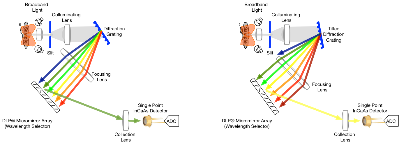

8. Can I change the resolution and wavelength range of DLP NIRscan and DLP NIRscan Nano?
The optical architecture of the DLP NIRscan and DLP NIRscan Nano can accommodate various resolution and wavelength ranges with minor changes to the optical layout.
- Changing resolution:
- The resolution of the system is dependent on the convolution of the slit width, optical point spread function, and DMD pattern width. As pattern and slit width decreases, less light reaches the detector. This leads to some tradeoffs between SNR and resolution. Refer to the Flexible Trade-offs in Maximizing SNR and Resolution in TI DLP® Technology-Based Spectrometer Systems Application Report for detailed information on these tradeoffs between SNR and resolution with different slit and pattern widths.
- Changing wavelength range or bandwidth:
- The wavelength range or bandwidth is dependent on the grating's groove spacing and the distance between focusing lens and grating. For the same grating and focusing lens, the farther the lens to the grating, the smaller the wavelength range. The smaller wavelength range allows for finer resolution at the same slit and pattern width. Note that the slit is imaged onto the DMD, so changing the distance of the DMD to the grating requires changes to the focusing lenses and their spacing. The DLP NIRscan has a wavelength range of 1100 nm while the DLP NIRscan Nano has a wavelength range of 800 nm.
- Shifting the wavelength range:
- The tilt of the grating dictates the set of wavelengths that fall on the DMD's active area. Tilting the grating shifts the wavelength range of the system. In the DLP NIRscan Nano a few degrees of tilt on the grating would change the wavelength range of 900 - 1700nm to 1100-1900nm. This will not change the wavelength range of the system, just shift the start and end wavelength points. Since the slit is imaged onto the DMD, the slit position must be adjusted to refocus all the wavelengths at the DMD with the change in the grating tilt. The grating tilt is not inherently adjustable in the NIRscan Nano, and will require some physical modification of the chassis around the grating.
- The DLP NIRscan and DLP NIRscan Nano have InGaAs photodetectors optimized for a specific wavelength range. Thus, shifting the wavelength range requires replacing the photodetectors to support the new wavelength range. For example, the DLP NIRscan Nano's photodetector sensitivity rolls off sharply at 1700nm, so a system supporting 1100-1900nm would need to be replaced with an extended range detector that is sensitive to 1900nm. Refer to Signal Chain Performance Optimizations in the TI DLP® Technology-Based Spectrometer Application Report for examples of extended range photodetectors and the appropriate transimpedance amplifier considerations. During production of the EVM, the detector is also flown in place on an x-y-z translation stage to maximize received signal, and then glued in place. Replacing the photodetector requires the alignment process to be repeated and potentially moving the condenser lens position to accommodate the new detector.
- The following efficiency losses might require more powerful illumination sources to counteract the lowered system throughput. The efficiency loss depends on the new wavelength range and sensitivity of the new detector.
- The blazed diffraction grating efficiency decreases when it is used at wavelengths farther from its nominal blaze wavelength.
- The lenses anti-reflective (AR) coatings are less effective at longer wavelengths. The lens glass absorption increases noticeably past 2000nm.
- The diffraction efficiency of the DMD may decrease at the longer wavelengths.
- Extended photodetector sensitivity tends to be lower than the non-extended photodetectors.
- When simulating the new optical design to determine the appropriate grating tilt angle, ensure that the wavelengths of interest are not being vignetted at the edge of the DMD. Keep in mind that mechanical tolerance stackup can cause small shifts in the wavelength position at the DMD. The amount of margin necessary between the measurement wavelengths and the edge of the DMD array will vary based on the accuracy of the grating tilt adjustment.
- It will also be necessary to replace the long wavelength pass filter that is located between the collimating lenses and the diffraction grating. For example, in the DLP NIRscan Nano, this filter blocks light below 900nm from reaching the grating in order to prevent stray light from the second diffraction orders of short wavelength light reaching the DMD. A new filter with a cutoff appropriate for the shifted measurement spectrum should be used.
- Modifications to the chassis are necessary to allow for grating tilt and the potential movement of condenser lens to accommodate the new detector.
- Finally, end calibration will be dependent on the calibration sources chosen for your target wavelength range. For example in the DLP NIRscan Nano, the GUI software needs to be modified to calibrate for the shifted wavelength range, since it is currently optimized to calibrate a 900-1700nm instrument.
