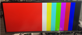

I used the 941AS splitter mode but could not output the picture. Besides, I try config SA8155 output 1920x720 or 960x720 size image ,and config ub941 work in single FPD-LINK Transmitter mode, Panel0 can display image
More Info:
1. Host SoC: Qcom SA8155
2. Host Soc output timing info:
1920*720@60
    uVisWidth        = '1920'
    uHsyncFrontPorch = '50'
    uHsyncWidth      = '50'
    uHsyncBackPorch  = '50'
    uVisHeight       = '720'
    uVsyncFrontPorch = '50'
    uVsyncWidth      = '50'
    uVsyncBackPorch  = '50'
    uPixelFreqInHz   = '108054000'
960*720@60
    uVisWidth        = '960'
    uHsyncFrontPorch = '25'
    uHsyncWidth      = '25'
    uHsyncBackPorch  = '25'
    uVisHeight       = '720'
    uVsyncWidth      = '50'
    uPixelFreqInHz   = '54027000'
3. config SA8155 output 1920x720 or 960x720 size image ,and config ub941 work in single FPD-LINK Transmitter mode, Panel0 can display image
4. config SA8155 output 1920x720 size image ,and config ub941 work in attern Generator, set 0x65 = 0xc,Panel0 can display image
5. config SA8155 output 1920x720 size image ,and config ub941 work in attern Generator, set 0x65 = 0x8,Panel0 can not display image
6. config SA8155 output 1920x720 size image ,and config ub941 work in attern Generator, set 0x65 = 0x8; 0x5b = 0x1,Panel0 can display image
Could you please help to check when i would like to use Symmetric Splitting - left/right setting, what configuration should be set to 941AS to successfully output the SoC picture?
Thanks!

     I try config SA8155 output 1920x720 size image ,and running 2 displays with resolution of 960x720, but can not display image.
    Besides, My screen supports 1920x720 and 960x720 resolutions.And the PCLK for both resolutions is exactly twice as high.
    I try the setting of  3840x720-Sym-Split-Script-Superframe_5F00_PCLK216.py .The phenomenon is the same as before(backlight is on, but panel not display image);

  • I try the setting of  1920x720-Sym-Split-Script-Superframe_5F00_PCLK108.py .The phenomenon is the same as before(backlight is on, but panel not display image);
    Difference between 0x8 and 0xC is toggling bit2 which selects the timing for the internal generated pattern. In Independent 2:2 mode, this controls the selected FPD-Link III port. which you could select through register 0x1E.
    0xC = The Pattern Generator creates its own video timing so uses internal timing from 941AS.
    0x8 = The Pattern Generator uses external timing from the pixel clock - This could indicate there is a pixel CLK issue from the SoC
    0x5b = 0x1 is forcing single FPD-Link  on Port0 only and disabling Port1 so that makes sense that you would only see display on panel0.
    In your case, you need to set 0x5B = 0x07 for Splitter mode.

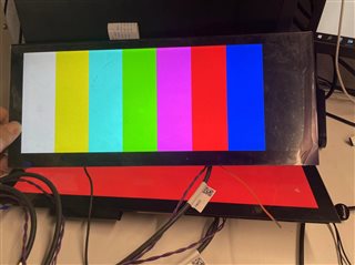

  • Hi Fadi:
    When you say it works in single FPD-Link Transmitter mode, are you talking about Internal PATGEN from 941AS to display or is does it work when using the SoC: Qcom SA8155 video output ?
    What is the exact timing you were using here for the working case?

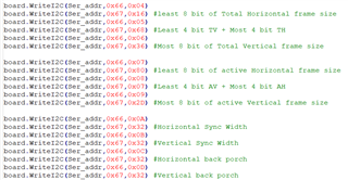

    I've tested it both ways: PATGEN and SoC: Qcom SA8155 video output
    Please refer to the picture below for setting of PATGEN. 0x1e = 0x1
    Yes, you right. I just want to test whether it is the problem of SOC: video output. According to the current phenomenon, there is no problem with SOC: video output, but we still cannot display it through split mode
  • Hi Alex,
    What Des do you use here?
    Can you send me the timing for the working panel?
    So you got Patgen from 941 as well as SoC video to work when using a single FPD port0 to display?
    Do you have access to ALP ?  If no can you download ALP and do you have USB2ANY or Ardvark that you can connect to local I2C of 929?
    I can't see this image it's blurry.
    Fadi A.

    Here are the results I got:
    Setup:
    Output: using a dual panel display, first 948 (port0) connected to left side panel, 2nd 948 (port1) connected to right side panel.

    1- confirm you have Lock on both Des0 and Des1
    2- confirm the output matches the expected image below
    output: using a dual panel display, first 948 (port0) connected to left side panel, 2nd 948 (port1) connected to right side panel.

  • Hi Fadi:
    I tried this script and the results are as follows:
    The result of Auto-Detect FPD-Link III mode_941AS_1920_720_Per_Panel.py:
    1. The screen cannot be displayed using this script
    2. Add 0x01 = 0x0 to this script, the screen can display image.
    The result of splitter_mode.py:
  • Hey Alex,
    That is because the DSI is held in reset state at the beginning of the script ... board.WriteI2C(Ser_addr,0x01,0x08) we forgot to release it (0x01 = 0x0)
    Looks like the original script did have this release, but I forgot to add it to this one.
    Based on these results, this means the internal patgen with internal timing/clk is working as expected which means the issue is coming from the SoC side.
    You can further narrow down the issue by doing the following:

    2- Run this script - this is set to internal patgen using internal timing with external CLK (if this doesn't work then it points to an external pixel clock issue)
    import time
    # timing for each panel is 1920*720@60
    # Total Horizontal = '2070'
    # uVisWidth        = '1920'
    # uHsyncFrontPorch = '50'
    # uHsyncWidth      = '50'
    # uHsyncBackPorch  = '50'
    # Total Vertical   = '870'
    # uVisHeight       = '720'
    # uVsyncFrontPorch = '50'
    # uVsyncWidth      = '50'
    # uVsyncBackPorch  = '50'
    # uPixelFreqInHz   = '108054000'
    Ser_addr = 0x18
    time.sleep(0.5)
    board.WriteI2C(Ser_addr,0x01,0x08) # Reset
    board.WriteI2C(Ser_addr,0x01,0x02) # Reset
    time.sleep(0.5)
    board.WriteI2C(Ser_addr,0x5B,0x07) #Set 941AS to Splitter mode
    board.WriteI2C(Ser_addr,0x1E,0x01) #Select FPD-Link III Port 0
    board.WriteI2C(Ser_addr,0x66,0x1A)
    board.WriteI2C(Ser_addr,0x67,0x01) #M=1
    board.WriteI2C(Ser_addr,0x66,0x03)
    board.WriteI2C(Ser_addr,0x67,0x02) #N=2
    board.WriteI2C(Ser_addr,0x66,0x04)
    board.WriteI2C(Ser_addr,0x67,0x16) #least 8 bit of Total Horizontal frame size
    board.WriteI2C(Ser_addr,0x66,0x05)
    board.WriteI2C(Ser_addr,0x67,0x68) #Least 4 bit TV + Most 4 bit TH
    board.WriteI2C(Ser_addr,0x66,0x06)
    board.WriteI2C(Ser_addr,0x67,0x36) #Most 8 bit of Total Vertical frame size
    board.WriteI2C(Ser_addr,0x66,0x07)
    board.WriteI2C(Ser_addr,0x67,0x80) #least 8 bit of active Horizontal frame size
    board.WriteI2C(Ser_addr,0x66,0x08)
    board.WriteI2C(Ser_addr,0x67,0x07) #Least 4 bit AV + Most 4 bit AH
    board.WriteI2C(Ser_addr,0x66,0x09)
    board.WriteI2C(Ser_addr,0x67,0x2D) #Most 8 bit of active Vertical frame size
    board.WriteI2C(Ser_addr,0x66,0x0A)
    board.WriteI2C(Ser_addr,0x67,0x32) #Horizontal Sync Width
    board.WriteI2C(Ser_addr,0x66,0x0B)
    board.WriteI2C(Ser_addr,0x67,0x32) #Vertical Sync Width
    board.WriteI2C(Ser_addr,0x66,0x0C)
    board.WriteI2C(Ser_addr,0x67,0x32) #Horizontal back porch
    board.WriteI2C(Ser_addr,0x66,0x0D)
    board.WriteI2C(Ser_addr,0x67,0x32) #Vertical back porch
    board.WriteI2C(Ser_addr,0x65,0x0C) #using internal timing and external clock
    board.WriteI2C(Ser_addr,0x64,0x15) #enable PG/color bars
    board.WriteI2C(Ser_addr,0x1E,0x02) #Select FPD-Link III Port 0
    board.WriteI2C(Ser_addr,0x64,0x31) #enable PG/color bars
    board.WriteI2C(Ser_addr,0x07,0x58) #0x07,0x58
    board.WriteI2C(Ser_addr,0x08,0x5C) #0x08,0x5c
    board.WriteI2C(Ser_addr,0x03,0x9A) #0x03,0x9A Enable I2C_PASSTHROUGH, FPD-Link III Port 0
    board.WriteI2C(Ser_addr,0x1E,0x02) #Select FPD-Link III Port 1 0x1E,0x02,
    board.WriteI2C(Ser_addr,0x08,0x5E) #0x08,0x5E
    board.WriteI2C(Ser_addr,0x03,0x9A) #0x03,0x9A Enable I2C_PASSTHROUGH, FPD-Link III Port 1
    board.WriteI2C(Ser_addr,0x1E,0x04) #0x1E,0x04
    board.WriteI2C(Ser_addr,0x01,0x00) #Release DSI

    Fadi A.
  • Hi Fadi:
    I had tried that using external timing/CLK from SoC, but panel cannot display image.
    if config 941 working in forcing single FPD-Link mode,and SOC video output has not change ,PATGEN work well . Based on these results,  i think there is no problem in soc side.
    Could you please help to guide us on what the problem is with soc side?
    I tried this scripts and the results are as follows:

  • Hey Alex,
    We need to get a register dump of the 941AS to review it. If possible can you provide the register dump of 941AS and 948? If you could do a dump during the run where you have a single panel0 working vs. when both panels aren't working ?
    • That is expected if your superframe image size outputted by SoC is 1920x720 --- if you want both displays to work correctly you need your superframe to be running at 3840x720 @  216 Mhz
    • When you say panel0 can display image , what is happening to panel1 ? Do you have Lock on panel1 but no video output or you don't have Lock?
    • Saying Patgen work well, what patgen are you referring to here? Is that the patgen coming from the SoC or you mean internal patgen from 941 ?
    • Are you saying that when you force 941AS to single link mode you do see the SoC outputting video to the screen on panel0 ? What image size is the SoC sending as the superframe in this case?
     using splitter_mode_internal_timing_externel_clk.py, config soc output 1920x720 size image ,panel can display image
    • You are saying that SoC output 1920x720 image size? I thought the superframe image coming from the SoC was outputting 3840x720 size image?
    • Do you still see lock high on both Des0/1 when display can't output image?

    reg config:
     0x01,0x08, // Reset
     0x01,0x02, // Reset
     0x5B,0x07, //Set 941AS to Splitter mode
     0x56,0x80, //Set 941AS to Splitter mode
     0x1E,0x01, //Select FPD-Link III Port 0
     0x66,0x1A,
     0x67,0x01, //M=1
     0x66,0x03,
     0x67,0x02, //N=2
     0x66,0x04,
     0x67,0x0b, //least 8 bit of Total Horizontal frame size
     0x66,0x05,
     0x67,0x64, //Least 4 bit TV + Most 4 bit TH
     0x66,0x06,
     0x67,0x36, //Most 8 bit of Total Vertical frame size
     0x66,0x07,
     0x67,0xc0, //least 8 bit of active Horizontal frame size
     0x66,0x08,
     0x67,0x03, //Least 4 bit AV + Most 4 bit AH
     0x66,0x09,
     0x67,0x2D, //Most 8 bit of active Vertical frame size
     0x66,0x0A,
     0x67,0x16, //Horizontal Sync Width
     0x66,0x0B,
     0x67,0x32, //Vertical Sync Width
     0x66,0x0C,
     0x67,0x16, //Horizontal back porch
     0x66,0x0D,
     0x67,0x32, //Vertical back porch
     0x65,0x00, //using internal timing and internal clock
     0x64,0x15, //enable PG/color bars
     0x1E,0x02, //Select FPD-Link III Port 0
     0x66,0x1A,
     0x67,0x01, //M=1
     0x66,0x03,
     0x67,0x02, //N=2
     0x66,0x04,
     0x66,0x05,
     0x66,0x06,
     0x66,0x07,
     0x66,0x08,
     0x66,0x09,
     0x66,0x0A,
     0x66,0x0B,
     0x66,0x0C,
     0x66,0x0D,
     0x64,0x31, //enable PG/color bars
     0x01,0x00, //enable DSI
     0x07,0x58, //0x07,0x58
     0x08,0x5C, //0x08,0x5c
     0x03,0x9A, //0x03,0x9A Enable I2C_PASSTHROUGH, FPD-Link III Port 0
     0x1E,0x02, //Select FPD-Link III Port 1 0x1E,0x02,
     0x08,0x5E, //0x08,0x5E
     0x03,0x9A, //0x03,0x9A Enable I2C_PASSTHROUGH, FPD-Link III Port 1
     0x1E,0x04, //0x1E,0x04

    Please confirm that this is the timing that's programmed into the SoC and it's outputting as a superframe 3840x720 image running @ 216.108 mhz
     try the setting of  splitter_mode_internal_timing_externel_clk.py when superframe image size outputted by SoC is 3840x720 .The phenomenon is the same as before(backlight is on, but panel not display image);
  • Hi Fadi:
    There is script: using internal timing clk to display image

    reg config:
     0x01,0x08, // Reset
     0x01,0x02, // Reset
     0x66,0x1A,
     0x67,0x01, //M=1
     0x66,0x03,
     0x67,0x02, //N=2
     0x66,0x04,
     0x66,0x05,
     0x66,0x06,
     0x66,0x07,
     0x66,0x08,
     0x66,0x09,
     0x66,0x0A,
     0x66,0x0B,
     0x66,0x0C,
     0x66,0x0D,
     0x65,0x04, //using internal timing and internal clock
     0x66,0x1A,
     0x67,0x01, //M=1
     0x66,0x03,
     0x67,0x02, //N=2
     0x66,0x04,
     0x66,0x05,
     0x66,0x06,
     0x66,0x07,
     0x66,0x08,
     0x66,0x09,
     0x66,0x0A,
     0x66,0x0B,
     0x66,0x0C,
     0x66,0x0D,
  • Hi Fadi:

    Can you try running this script?
    import time
    # timing for each panel is:
    #960*720@60
    #uVisWidth        = '960'
    #uHsyncFrontPorch = '25'
    #uHsyncWidth      = '25'
    #uHsyncBackPorch  = '25'
    #uVisHeight       = '720'
    #uVsyncFrontPorch = '50'
    #uVsyncWidth      = '50'
    #uVsyncBackPorch  = '50'
    #uPixelFreqInHz   = '50 Mhz
    Ser_addr = 0x18
    time.sleep(0.5)
    time.sleep(0.5)
    board.WriteI2C(Ser_addr,0x67,0x04) #N=4
    board.WriteI2C(Ser_addr,0x67,0x0B) #least 8 bit of Total Horizontal frame size
    board.WriteI2C(Ser_addr,0x67,0x64) #Least 4 bit TV + Most 4 bit TH
    board.WriteI2C(Ser_addr,0x67,0xC0) #least 8 bit of active Horizontal frame size
    board.WriteI2C(Ser_addr,0x67,0x03) #Least 4 bit AV + Most 4 bit AH
    board.WriteI2C(Ser_addr,0x67,0x19) #Horizontal Sync Width
    board.WriteI2C(Ser_addr,0x67,0x19) #Horizontal back porch
    board.WriteI2C(Ser_addr,0x65,0x04) #using internal timing and internal clock
    board.WriteI2C(Ser_addr,0x64,0x31) #enable PG/red
