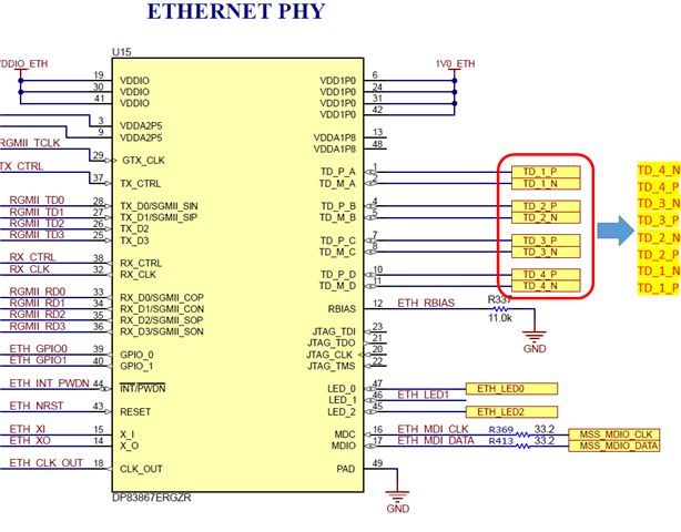

I am trying to design a board using the same ETHER-PHY (DP83867E) and RJ-45 connector used in TMDS273GPEVM, DP83867E with mirror mode enabled and SGMII disabled.
Q1.Is the starp configuration of LED_0 correct with Rhi=5.76k-ohm, Rlo=2.49k-ohm?
Q2.When using in mirror mode, is the connection between TD_P/M_A to TD_P/M_D and RJ-45 correct according to the diagram below?

    Please find my responses below:
    Mirror Mode Enabled and SGMII Disabled would be Mode 3 for LED_0, your Rhi and Rlo values are correct. This should give you your intended function.
    I believe you have connected them correctly but please double check Section 8.4.6.5 Mirror Mode in the Datasheet.
