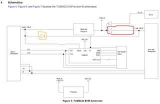

  • Thank you for your quick answer!
    I also found a schematic from your EVAL EVM board. May can answer here two questions:
    1) Red circle:
    Why is here a Schotky diode placed? My understanding is that this connection should not be necessary. The "IN" of the TPS25910 is supplied by the PWR_IN and the uAB_VBUS should be directly connected to the "OUT" of TPS25910.
    2) Orange circle:
    Also here the question, why there is a Schotky diode placed? What would change (advantage/disadvantage) if it is replaced by a "0" Ohm resistor?
    Many thanks!
  • Hi Roland,
    When you consider this EVM is placed between the upstream facing micro-AB receptacle, and the downstream facing Type-C receptacle, these diodes are ok to have.
    The diode in red allows VBUS to enter the VBUS switch from the UFP micro-AB receptacle. This would also let the micro-AB VBUS drive PWR_IN, as PWR_IN can be powered from a DC input, the micro-AB VBUS, or the Type-C VBUS depending on the configuration.
    When the 320 is configured as a source (DFP) the VBUS switch connects the input (either from micro-AB or DC_IN) to the output on the Type-C_VBUS.
    When the TUSB320 is connected as a UFP, the VBUS comes from the Type-C receptacle. In this case the VBUS switch is disabled, yet the diode in yellow will allow the Type-C_VBUS to loop around to micro-AB VBUS, then drive PWR_IN.
    If the diode in yellow was replaced with a 0-Ohm resistor, the micro-AB VBUS could entirely pass the VBUS switch with no consideration of UFP/DFP on the CC controller. This may not be desired if you connected a micro-AB cable yet still want a UFP configuration on the CC controller.
