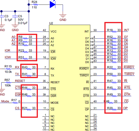

Inaddition, it can be found in the EVM board manual that all data buses will have a 33 ohm resistor in series. Is this for current limiting or EMI suppression? Is this a must?
    The 33 ohm resistors are there to limit some current in the case of a short, but they are mainly there if we needed to do debugging. They are not required, for an EVM having series resistors that can be depopulated is useful.
    -Bobby
